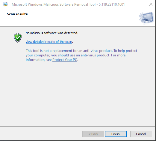

 @Leatherface proposed to me to run "Click windows+R key, then type MRT and hit enter " It will remove malicious software.
I did it already but without any success.

Unplugged and re-routed many usb's I had for rgb etc to my surge protector instead of pc. Unplugged usb expanders and went straight to pc rather than using usb hubs. Running MRT right now and will update when it is done. I surely hope this fixes my issue, I thought it might be a driver issue but all of my drivers are up-to-date and I have no virus's either. Thank you guys for the help!
