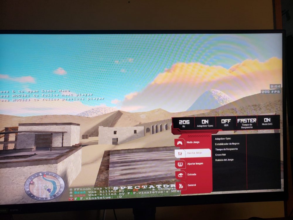

im about to quit the game if i dont find the solution to my problem chance new monitor and all got worst make a few changes and nothing help

im using wondows 10 21H2
Intel(R) Core(TM) i5-9400F CPU @ 2.90GHz   2.90 GHz
r«try everything i can but all seem the same i use a new config iff needed

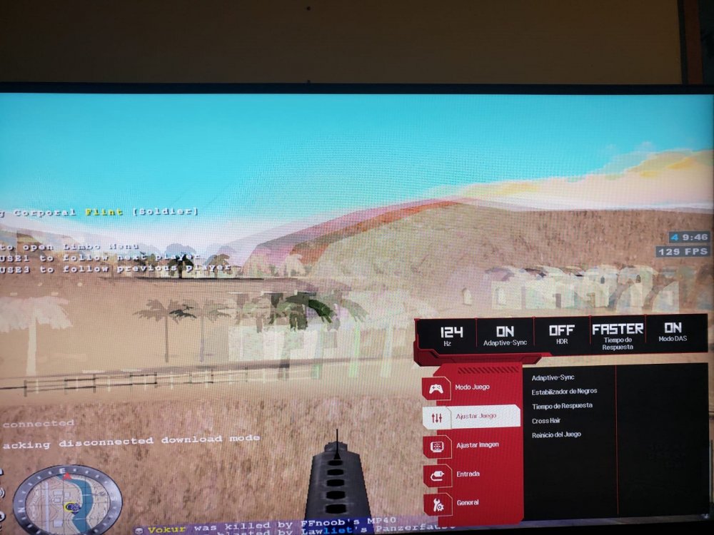

Idk why but my monitor refresh is 144 but for some reason if i use this setting i have bad laggy screen. So i still use 60. Might give it a try

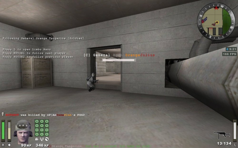

heres screenshot of me with 143 fps.
