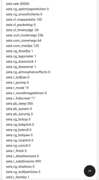

Whenever I play, no matter what server I play on I always lag. I tried running the pk3 cleaner and changing things in my config and nothing has worked. If anyone has any suggestions on any way to improve this I would appreciate it. I found this config on the internet and this is what I’ve changed everything to.

I tried both of these. /r_primitives 2 doesn’t work. It say’s unknown cmd. I’m also tried turning off the auto searching for connections. Same lag persists.
