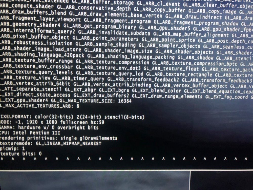

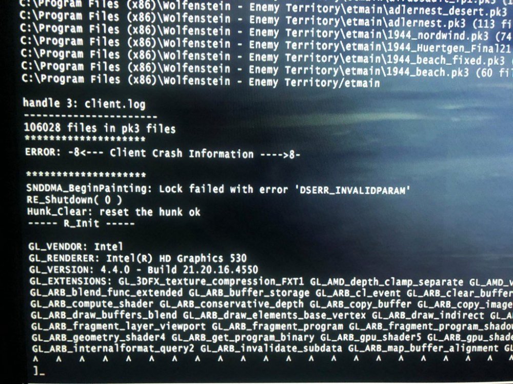

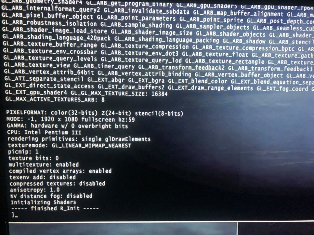

I tried Fun 1 and everything works as it should. Then disconnected (not closing ET) and went to NQ1 and even from spec I was kicked again. Tried 3 times and all the same result. Took followed screens.

Last time I saw -8<----- crash information ----->8- it was related to a map/pk3 having a sound bug in it related to T/chat and esc/menu
Look in your etmain folder for FA_baserace_v1.pk3. This map caused issues for weeks/months to many players. But NQ players were ok, it was an issue on other mods having that file in etmain
if you have that map delete it plz
