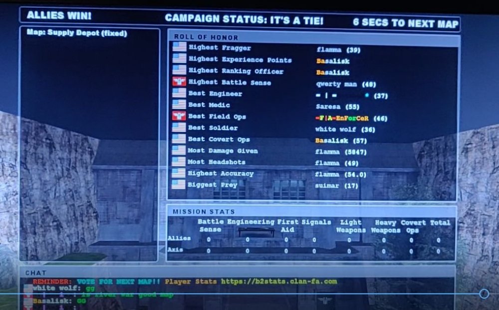

ShaDoW1 Posted May 8, 2020 Share Posted May 8, 2020 (edited) Hi guys, Since a got back I noticed I'm not always able to vote for the next map during intermission time. So far, I've only played on Beginners#2, but I expect that I have this problem on all Silent servers. I think it is related to my client, I'm using ET legacy 2.76. Before I was using version 2.75 (where I did not see the problem), maybe a bug in ET legacy introduced in the new version. Also one of my friends had the same problem with ET legacy 2.76 on beginners #2. Anyone else experiencing this problem? Uploaded video to wetransfer, find link below because file is too big for the forum. (only available for 7 days) https://we.tl/t-JmqNJCKeWH PS: Please ignore my sucky score during that map 😂 Edited May 8, 2020 by ShaDoW1 1 1 Quote Link to comment Share on other sites More sharing options...

Leader RedBaird Posted May 9, 2020 Leader Share Posted May 9, 2020 (edited) On 5/9/2020 at 1:34 PM, ShaDoW1 said: I've created a ticket to ETlegacy on their Github. https://github.com/etlegacy/etlegacy/issues/1454 The video downloads as an MP4. ShadoW1 had been switching through the three display screens at end of map in his recording. This SS is at 6 seconds to next map but does not show the map-voting display in the left window. I should make it very clear that the map-vote menu had never showed whenever ShadoW1 had switched to this screen. This is probably not related to the glitch, but check for voting the next time that the Campaign Status is a Tie ...just in case. Edited May 11, 2020 by RedBaird clarify that map-vote menu missing every time that I should have showed up 1 Quote Link to comment Share on other sites More sharing options...
