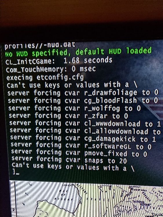

1320408383_ETPIX.thumb.jpg.2c47dd7e20574a8643f5fe04b106a83f.jpg Well W-10 strikes again. When I log in HardCore this is what I get. No changes have been made since I was reset, other then setting Administrator rights on short cut. Any ideas...
Is that "can't use \" blocking your ET-playing?
You could open your etconfig.cfg and search for any "\"s in it.
I can experiment with mine to find when such an error occurs...brb.

That "\" is very suggestive of a Windows\style\directory address.  It is very rare for NTFS to mess up these days, but maybe another file got appended to your etconfig.cfg, or something.  Some cvar might have an directory/address in it for some reason... :?:

Your error statement is right where my ' exec etconfig.cfg ' appears,  which may mean that your path has \s instead of /s in it.  Check for that.  I will change my file and double-check it...

I did look at the source code and found a common string-parser-function that checks for " \ ", " ; and " // " in the strings fed to it, and returns that same error-statement, with the proper character added at the end.
