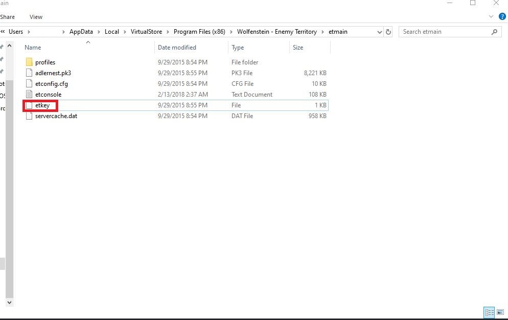

could you see if you have an etkey file in this directory:
C:\Users\%username%\AppData\Local\VirtualStore\Program Files (x86)\Wolfenstein - Enemy Territory\etmain
%username% would be replaced with the one you use.

1 hour ago, Moatazmell said:
That looks like what would be in the profiles folder. You don't want to go that deep. This would be what you're looking for:
This folder is where the ETKey (your xp) and profile (name, config, etc) is saved when ET is not run as an administrator.
