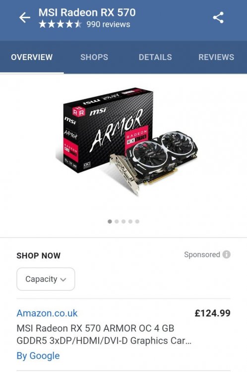

HOTSPUR Posted April 29, 2019 Share Posted April 29, 2019 Amd rayzen 5 with maybe a 570 graphics card 1 Quote Link to comment Share on other sites More sharing options...
HOTSPUR Posted April 29, 2019 Share Posted April 29, 2019 Quote Link to comment Share on other sites More sharing options...

captnconcrete Posted April 29, 2019 Author Share Posted April 29, 2019 radeon is ati .. i wouldnt use that for a wheel stop but thanks for info im touch and go right now.. 600 too 800 if thats doable.cheaper is better .. an im a msi fan cuz this board im on now is like 14 yrs old and didnt give one problem . other then sata port dieing in that many yrs till now. once i upgraded that cpu xern all went to hell. i think im supposed to have 1066 ram with that cpu.. board tries to oc my ram if i put in more than 4 gigs.its 6400ddr2 800 now lollolol basically now i would like info on board gpu psu case and hdd.. Quote Link to comment Share on other sites More sharing options...
