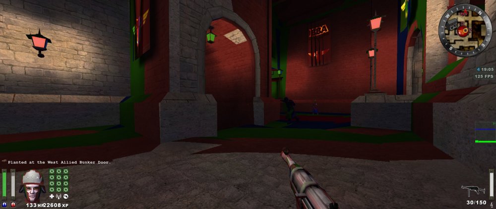

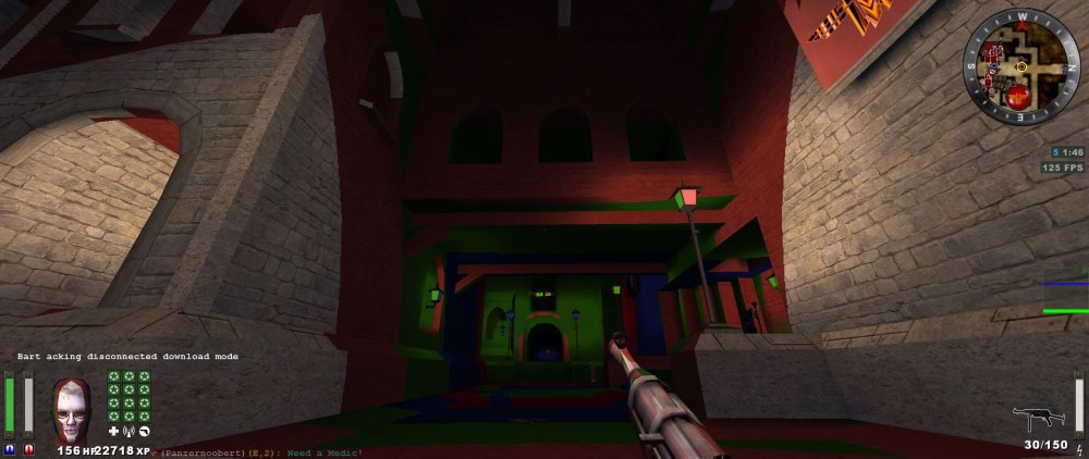

I hope someone can help me with this, experiencing a weird config problem. Please, see the attached screenshots how my screen looks like
Tried to load various other configs, but the problem remains the same.

Did you try cvar_restart? If it's some odd setting that most configs don't have, trying different configs wouldn't necessarily fix it.
As Mufasa says trying dif configs would only change what cvars are in said configs and would not "fix" the issue if a dodgy cvar has already been committed to the default etconfig.
I cant see anything in your cfg above that would cause your issue which tells me if its anywhere it would be a cvar in the default etconfig.cfg. Your cfgs only override cvars you put in your cfg and everything else comes straight from the default etconfig.cfg, maybe try and remove the etconfig.cfg (by remove i mean move it out the folder temporarily) and let ET create a new one from scratch and take it from there.
Edited by Snuffs99
Follow Mufasa and snuffs99 advice Btw if he doesent work , save you'r etkey and uninstall and delete all files from Wolfenstein.

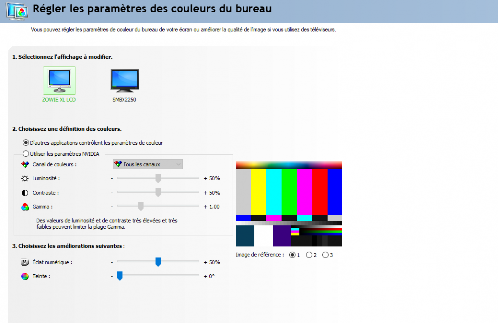

What is you'r graphic card? if it's Nvidia post me  you'r color setting   like my screenshot .
Haha i too was thinking gfx card settings if nothing else worked so nice to know it wasn't just me.....although the only setting that would change the real colour is the hue, but that would affect everything and not just ET.
yeah i know  this probably don't from gfx card but we search anywhere ? Indeed by clear all ET files and uninstall this should work

cvar_restart heps. However, when I load my rendering config, the problem is back, meaning it is something in my config. I guess I will need to go slowly throught the settings and see what it is. Once I have something to blame, will come back and share the solution with you. Thank you all for helping!
  • Solution
Hi guys, as promised I am back to report who is to blame :P
seta r_ext_compiled_vertex_array "1"
had it on 0, instead of 1
Thank you all once again for your help!
