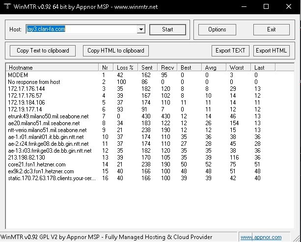

I think a few days jay3 that is in Germany, has serious problems of lag, and also doing the tracer, I note that the problem is almost always frankfurt, someone can explain this problem, I'm monitoring for 1 year and a half ,
having the dynamic IP address, it is sufficient to restart the router to return to the original latency, but yesterday it did not work
Moreover, I am 6 months old that I changed Internet and Router line, it works well in download and upload, and even in game I can not complain, I do not have packet loss, and I can kill, without problems, instead if I use,
WinMTR, I have very serious packet loss problems
look at the picture
I'm demoralized

if I call my ISP and I talk to him about packet loss and WINMTR, they answer me saying that if the modem is aligned and the speed test signals the contract band, everything is OK for them,
is absurd, the line that I had previously despite that I played in wi-fi, at the test with WINMTR, the result was better if someone remembers

Run winMTR for 100 packets. Your first hop in itself have 40% packet loss.

MTR has always been like this, since they put the new line and the new modem
I had already shared my problem with you, months ago
but I have not been very listened to or advised
indeed, WINMTR returns me very bad values

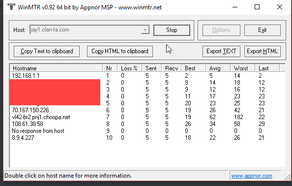

Based on the winMTR - which you are sharing - fault at your modem/router -
Here is example of mine -
in fact, my MTR of the old connection with the old modem, was the same as yours, only 2 or 3 loss packets in wi-fi
but it's normal
I will call my ISP and I will have the modem replaced, thanks for the confirmation and best wishes
