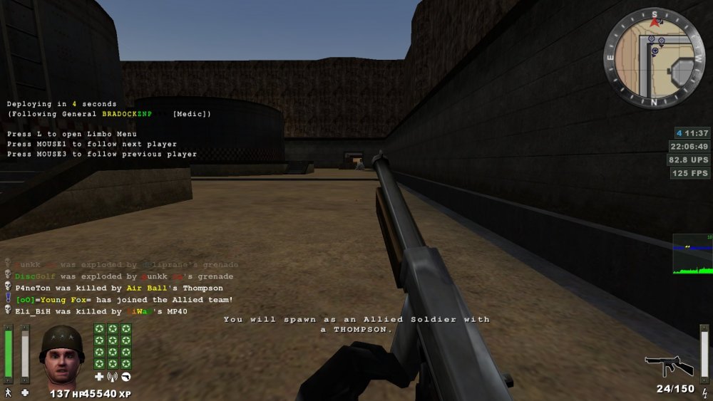

Young Fox Posted December 11, 2018 Author Share Posted December 11, 2018 (edited) le lagomètre: Et le WinMTR : Quote |------------------------------------------------------------------------------------------| | WinMTR statistics | | Host - % | Sent | Recv | Best | Avrg | Wrst | Last | |------------------------------------------------|------|------|------|------|------|------| | 192.168.1.1 - 0 | 58 | 58 | 1 | 3 | 10 | 3 | | 80.10.236.1 - 0 | 56 | 56 | 4 | 130 | 2923 | 5 | | 193.253.86.38 - 0 | 58 | 58 | 3 | 5 | 22 | 4 | | 193.252.103.242 - 0 | 58 | 58 | 5 | 8 | 25 | 8 | | 193.252.137.54 - 0 | 58 | 58 | 15 | 16 | 26 | 15 | | 193.251.131.11 - 0 | 58 | 58 | 15 | 21 | 63 | 15 | | 129.250.66.141 - 0 | 58 | 58 | 15 | 17 | 34 | 18 | | 129.250.5.39 - 0 | 58 | 58 | 86 | 89 | 104 | 92 | | 129.250.4.133 - 0 | 58 | 58 | 88 | 90 | 111 | 90 | | 129.250.4.24 - 0 | 58 | 58 | 26 | 29 | 41 | 31 | | 129.250.2.26 - 0 | 58 | 58 | 27 | 30 | 46 | 28 | | 129.250.2.18 - 0 | 58 | 58 | 89 | 92 | 106 | 91 | | 129.250.5.62 - 0 | 58 | 58 | 88 | 92 | 112 | 90 | | 129.250.5.89 - 0 | 58 | 58 | 95 | 105 | 127 | 105 | | 128.241.2.250 - 0 | 58 | 58 | 96 | 99 | 113 | 98 | | 108.61.2.89 - 0 | 58 | 58 | 91 | 96 | 126 | 94 | | 108.61.38.58 - 0 | 58 | 58 | 88 | 92 | 108 | 89 | | No response from host - 100 | 11 | 0 | 0 | 0 | 0 | 0 | | 8.9.4.227 - 0 | 58 | 58 | 88 | 91 | 107 | 89 | |________________________________________________|______|______|______|______|______|______| WinMTR v0.92 GPL V2 by Appnor MSP - Fully Managed Hosting & Cloud Provider Edited December 11, 2018 by Young Fox 2 Quote Link to comment Share on other sites More sharing options...
Administrators daredevil Posted December 11, 2018 Administrators Share Posted December 11, 2018 Can you make sure hostname is correct ? jay1.clan-fa.com U can copy paste that direct in hostname - make sure their is no space before or after. Also based on lagometer - I see massive green line changes - green line = client ping - if that changes something wrong on your ISP side but winMTR will tell that. 1 1 Quote Link to comment Share on other sites More sharing options...

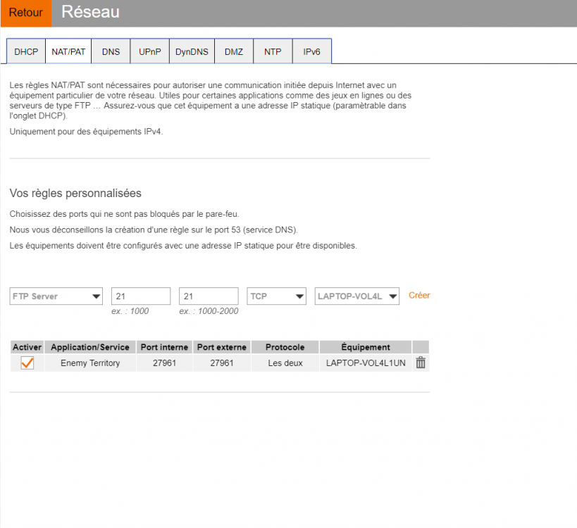

DoubleDragon Posted December 12, 2018 Share Posted December 12, 2018 Your modem's firewall maybe blocking the port access for the ip that comes back timed out you may need to Port Forward to the UDP connection for Wolfenstien Port 27960 for a open port just a thought Quote Link to comment Share on other sites More sharing options...
