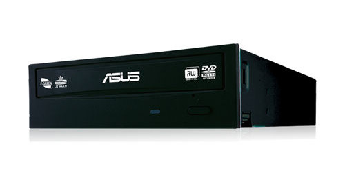

DVD/CD Burner-Reader (Optical Drive) = ASUS  #DRW24F1ST  24x DVD speed / CD Optical Burner / Reader
http://www.newegg.com/Product/Product.aspx?Item=N82E16827135305  =  $20.00 @ NewEgg
https://www.asus.com/Optical_Drives/DRW24F1ST/

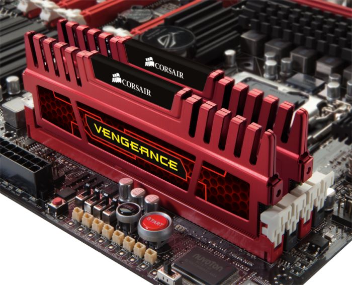

RAM / MEMORYOption #2 (RED Themed) CORSAIR Vengeance series 8 GB DDR3 1600 SDRAM
http://www.newegg.com/Product/Product.aspx?Item=N82E16820233180&leaderboard=1  =  $80.00 @ NewEgg
http://www.corsair.com/en-us/vengeance-8gb-dual-channel-ddr3-memory-kit-cmz8gx3m2a1600c9r
corsair-ram-desktop-ddr3-vengeance-2x-8g
