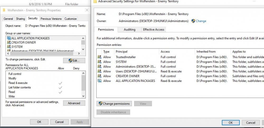

Right-click on Enemy territory folder, Properties, Security...
To change permissions, Click Edit...
Group or User names: To change permissions, click Edit,
Find: Computer Name or User in list of Group or user names,
Click on Computer name or User to highlight If You find, If Not click Add...Add User name in box...Click Ok
Permissions for Administrators: Fill in Allow boxes, Click OK
Edited by Buckwild

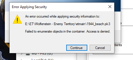

@Buckwild   I've tried that a bunch of different ways.  When I think I've fixed it and hit apply, i get this error message.
So at this point, I'm just trying to salvage some of the files to put into the new ET folder.  But the et key I moved into the main doesn't seem to have worked.

Just take ownership of the folder, changing permissions wont do much a deny always overrules allow.
So.....
Right click your ET folder and go to properties.
Click the security tab then "advanced" and a new window will pop up, at the top it will say owner...tick the box under owner where it says "Replace owner on subcontainers and objects" then click where it says "change" at the end of the owner.
Now click advanced then "find now" and a list of all available users on your system will appear, select your user name from the list then press OK, OK, apply and if asked say yes to all sub folders and files.
Windows will now reset all permissions and make you the owner of the ET folder and all folders and files within the ET folder.
Once the process has finished close all the windows and you should once again have full access to the ET folder.

He's already tried to do that
This is a group policy issue related to the folder being owned by the administrative group
he's either going to have to rejoin the group or login to administrator and assign a new user to the group policy
Must have missed that but tbf no where does it say that he has tried to take ownership of the folder and failed, only mentions changing permissions etc......And it may be a group policy issue but the folder being owned by the administrator group would not stop an admin account (specifically his) taking ownership.
