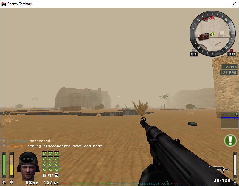

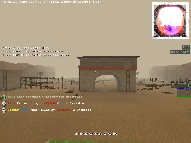

There's some sort of overlay on the minimap during desert baserace. I've played the map on B2 and it's fine there so I'm not sure why it's happening on Jay1. I'm not the only person having this issue, I asked Nerbil and Young Fox who were on at the time and they confirmed that they were having the same problem. I'd guess that it's happening for everyone else but only Chimichanga (not the bot) said he had the same issue.
I've tried reconnecting and that didn't fix the issue. Tried vid_restart too but no luck. Someone suggested cg_watermarkopacity/alpha 0 which didn't work either.
I can't play on Jaymod without the minimap, I look at it every other second :(

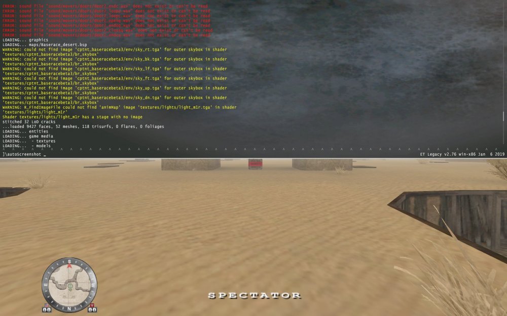

The skybox is missing shaders and your seeing the ambient collision from the caulk
As for the score it's in the compass you can't see it cause the collision is removing it

This is showing in ETLegacy 2.76
Couldn't add this to the previous post
the shaders are their and the bsp calls for the proper file name textures/cptnt_baseracebeta3/br_skybox in the shader
just curious is this the right one baserace_desert.bsp
	qer_editorimage textures/cptnt_baseracebeta3/env/sky_bk.tga

I just went to see, in my file Wolfenstein E.T, I only have Baserace_desert.pk3 (which is empty in addition) and Baserace2_b1.pk3
I do not have the one you specify

Try on your local host with bba0-beta2.pk3 on server.
Yep that's the one throwing the bug
baserace_desert.pk3\gfx\2d\scoreboard\ <---- has a shader file
bba0-beta2.pk3\gfx\2d\scoreboard\ <---- missing shader file
If it can be fixed through the patch I uploaded earlier to fix errors I will update it with a new shader file.

it is still present will continue until something gives
Im seriously thinking it's a jpg issue cause the numbers are black background with no shader file related scripting
refering to baserace_desert.pk3\gfx\2d\scoreboard\allies0.jpg and so on through the file
Im thinking cause it has no shader file and not tga format it's causing a issue
I've tried to trigger the remapshader at start in game_manger and // out the remapshader at start
it was clean to start with then the wait timer expired it went back to bug so it has to be this in theory

if rewriting the shader file to add the .\gfx\2d\scoreboard\allies0.jpg shaders and converting to tga with a blendFunc GL_ONE_MINUS_SRC_ALPHA doesn't work
then I will create a new compass.tga for each score and remapshader to a flush with a surfaceparm trans thats all I can think of
recompiling this map wouldn't fix it either this is a scripting image issue apparently
bba0 patch will be fixed tomorrow maybe this to
will get back here with results later on it's been a bugger lol
Took a while but I found it and now Im sleepy
Unfortunately there was no possible way to patch it had to scrap the old for the new because you would have had to put two files on the server to make one map so it's repacked to a new

Had this problem again on Jay1 10 minutes ago. If anyone else wants to fix this minimap issue then remove bba0-beta2.pk3 from your etmain directory.
Tried it minutes after El! did and worked for me as well. Took a few mins to readjust of not having to hit G to see nearby enemies
