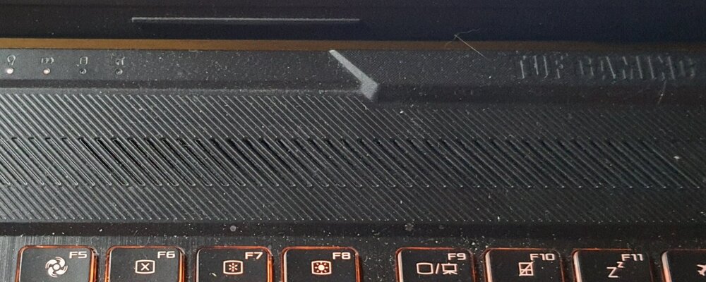

Jadream Posted November 10, 2024 Posted November 10, 2024 Hello everyone, so my issue is : since a few days ago, on Jay 1, my game freezes completely after playing few or longer minutes of a map, but I never make it to the end without the game completely freezing on me. Do you guys have any idea on what it could be ? Redbaird told me on Discord that it could be a overheating issue and I think he's right because when that happens my PC fans start getting really loud. I know it has nothing to do with my wifi as it works perfectly fine elsewhere. If anybody has any way of fixing this, please do, I'd be glad to hear it. Quote
Platinum VIP -=HipKat=- Posted November 10, 2024 Platinum VIP Posted November 10, 2024 How long has it been since you've thoroughly cleaned your case and fans, including the CPU fan and power supply fan, and refreshed your thermal paste? Quote
Jadream Posted November 10, 2024 Author Posted November 10, 2024 I've never really cleaned it. It could be the reason it overheats like this. Thanks, I will look for that. Just a thing though, since it's a laptop the fans are directly inside the computer, meaning I have to try opening it but I don't see how. I'll send a picture. Quote
Eazy Posted November 10, 2024 Posted November 10, 2024 1 hour ago, Armagedonyx said: The fans are underneath. Laptop usually have phillips screws on the below/under side. You need to unscrew them all , then pinch a small object between both layer (top and bottow parts) to split it open. That should give you a full view on both side interrior parts. If you not sure on how to, google your laptop brand &model and you should find video on youtube and tutorials 1 1 Quote
Leader RedBaird Posted November 10, 2024 Leader Posted November 10, 2024 (edited) 14 minutes ago, Eazy said: then pinch a small object between both layer I bought some guitar picks just for that. ADDED: You might see dust or hair on the air-intake on your laptop. I wonder if it has an internal filter of some sorts. Yeah, that "fans get loud" might be the last step before the CPU shuts down for self-protection. ... OR your graphics system might be overheating and 'freezing' the screen. (That now sounds ironic,: overheat -> freeze). Edited November 10, 2024 by RedBaird 1 1 Quote

Jadream Posted November 11, 2024 Author Posted November 11, 2024 (edited) Oh don't you worry I'm not doing any unscrewing. I never did that before and might need the help of my father whom I share the same appartment. Though, it seems that my game didn't freeze as much as the other days. I still get these occasionnal lag spikes but those don't happen everytime. I did some cleaning of my laptop today so I figured it might have helped. We'll have to see I guess. If it really overheats and I'm unable to clean it properly in the future, then I'll ask help to a professionnal or just my father I guess. Still, I appreciate all the help from you guys. I'll keep you posted if anything wrong happens later, I just hope not... lol. Edited November 11, 2024 by Armagedonyx 2 Quote
