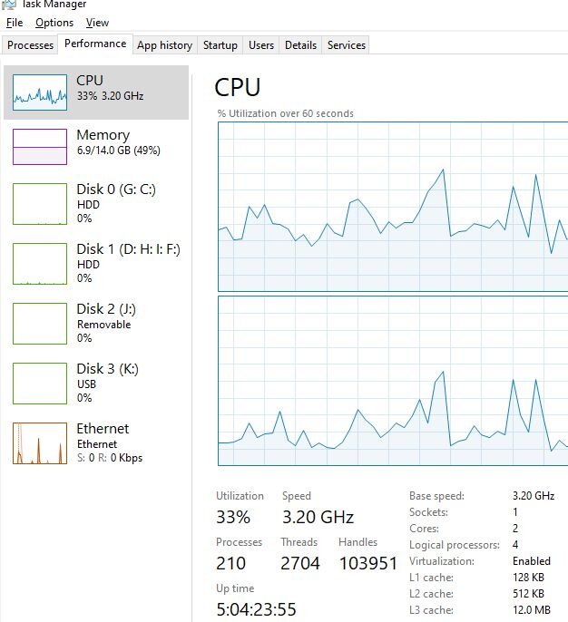

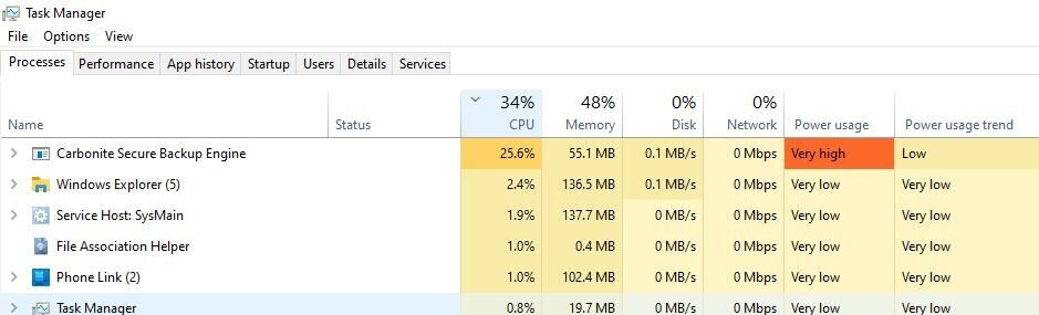

Leader RedBaird Posted November 6, 2023 Leader Share Posted November 6, 2023 I was just thinking that you could open Task Manager (if using Windows) and get an idea if something in the background is using resources. I keep it on the Task Bar. I sometimes have playing troubles when my online back program, Carbonite, starts running in the background, even though I set it to run when the computer is mostly idle. I guess that ET does not count as much of a load these days! Carbonite does 'steal' network resources when it runs. I opened my taskbar to get an SS, when I noticed unsual usages, for just having 32 browser tabs open. 😄 In that instant, Carbonite was not using the Internet very much, so the Ethernet window looks fairly normal. Checking the Processes page got this: I still didn't catch it when it was uploading or transferring information. You might not get the same results with a more modern computer, but I used this as an example of what a 'background process' could do. Then there are the various forms of malware. I don't think that a bitcoin-miner would bother trying to steal cycles from a motherboard GPU, but. A 're-mailer' is possible. 😄 You could just have a "corrupted" program or driver, too. AH, and you are probably using higher resolutions than I am. You might consider opening the Task Manager before starting ET. See what is 'normal' for ET and then check Task Manager when you have 'bouncy pings!' You could try running WinMtr (see FA files section) to see if some node in the path from your computer to FA-EU servers are having issues. You could also run it for the FA-US servers as a comparison. 2 Quote Link to comment Share on other sites More sharing options...
