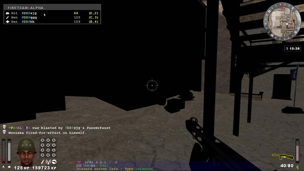

Hello, You may recognize me from begginers fa et server :) I have a graphics problem I can't resolve even after spending so much time on configuration.
Recently when I started playing ET again with my friends
I noticed some of the textures are black. Mostly all trees and bushes are black which doesn't affect the gameplay, however some shady areas have the same issue.
Before Oasis map was upgraded, small tunnel underneath the entrance on the right side between allied first spawn and the old city was completely black, I couldn't see where I was heading. Next Oasis version fixed the problem, as well as similar issues were fixed on newer versions of some other maps, however some maps like Tramfight still have this issue, and this is what it looks like (see attachment).
My ET version: ET Legacy v2.76 linux-i386 Jan  6 2019 (newer version crashes, doesn't start for me)
OS: Debian 12 Bookworm
Graphics: GF 750Ti
Driver version: 470.74
Please tell me if you need any more info, logs or config files.
Start by backing up your current config by connecting to Beginners #2 and entering this command in console:
 \writeconfig backup
This will create a file named backup.cfg in the folder of the currently loaded mod (probably for you at ~/.etlegacy/silent/backup.cfg). It is probably some bad combination of r_ignorehwgamma, r_overbrightbits, r_mapoverbrightbits, r_intensity, and r_gamma. You can probably solve it by resetting those to their default values but, if that doesn't work, upload backup.cfg here so we can take a look.
To rule out a non-ET setting or driver issue you should try resetting your ET configuration to default by entering these two commands in console:
\cvar_reset
\vid_restart
This will either fix the black texture issue (and mess up a bunch of your other settings) or it won't.
Let us know if it fixes the problem so we can continue debugging down one of two paths:
  • If it is fixed, the problem is in your config and we will be able to find it after you post it here.
  • If it is not fixed, there is probably a graphic driver setting or library issue.
To restore your existing setting and play with the issue in the meantime enter:
 \exec backup.cfg
 \vid_restart
