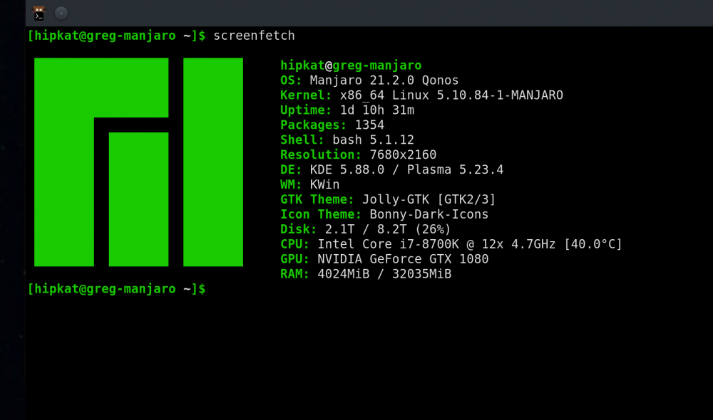

Platinum VIP -=HipKat=- Posted December 25, 2021 Platinum VIP Posted December 25, 2021 (edited) 1 hour ago, the cake is a lie said: The version of ETL you listed is over 6 years old. Try downloading the latest release 2.79 and see if you have the same issue. I have had the black/frozen on full screen issue at various times in the past with different version of ETL and different flavors of linux. It worked as expected in 2.77 then broken again in 2.78, then fixed in snapshot build 2.78.1-130.... and so on. Sometimes it would work correctly in ubuntu but not in KDE and vice versa. If the latest version of ETL doesn't work, post your OS and kernel version ($ uname -a), CPU, GPU model and driver version, and your ET config file from the legacy mod folder (this is the usually one loaded at ET startup). There is also an ETL discord server where you can ask the developers for help directly. I posted on the discords server last week - no real help there. I actually did get the newest version downloaded Thursday but haven't had time to run it yet. I will later today though - fingers crossed! Edited December 25, 2021 by -=HipKat=- 1 Quote
Platinum VIP -=HipKat=- Posted December 25, 2021 Platinum VIP Posted December 25, 2021 @the cake is a lie 2.79 is working. My ETKey is not. I have it in /var/lib/flatpak/app/com.etlegacy.ETLegacy/x86_64/stable/83cdfd32d9286a4f66c5f77c213177d12ceac1c13049d450c68a6c416af19b9c/files/bin/etmain/ - which is the default install path for ETL. All my maps and CFG's work out of that folder, but not my key. Am I missing something? Quote
