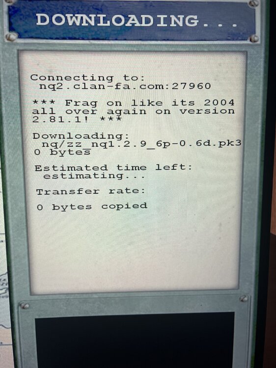

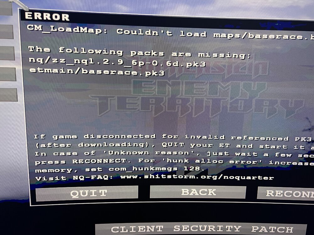

I am having a very hard time getting connected to the server. I have installed 2.76 and got it running. Every time I try to connect to the server ET crashes and opens a link to the FA homepage? This also happened with 2.60b. I have tried /cl_allowdownload 0 and 1 and still either crashed when set to 1 or get the image displayed below when set to 0. Any help would be appreciated!
I have the nq/zz_nq1 and baserace file in my nq folder already so I'm not sure why it's trying to download it.
Edited by nAbish

2.76 doesn´t seem to be running properly if in mixed installation envoirement with newer versions of ETL.
I´ve had that several times in the past with kaemon from ETL dev team, but they won´t fix it for old versions.
if it´s a clean standalone ETL 2.76 install, without newer versions it should still be operateable.
however
ET2.6b still works like a charm.
Rename your "nq" folder from the 2.6b game installation path (renameing it works also) to something like "nq-backup".
then the game will create a complete new folder called "nq" and will download everything automaticly.
ps.
map files should always go into "etmain" folder.
let me know how it went @nAbish
Edited by Vice86
  • Thanks 2
Same results
50 minutes ago, nAbish said:
Same results
let's try figure it out in discord voice chat,
I think I still got your Cfg somewhere
@Vice86 Got me fixed up, I can connect! For some reason my aim is very jumpy on server, including NQ1. Has anyone encountered this problem?
