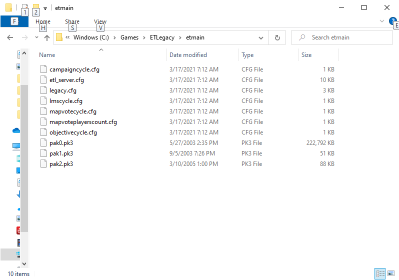

Thank ElEl, your explanation that I need pak0.pk3, pak1.pk3, and pak2.pk3 in my etmain folder for my ET installation is helpful but my etmain folder already contains these files:
I also have another ET Legacy version on my computer in a different folder (2.76) and it has all of the same problems, even though these same pk3 files are in that folder's etmain folder.
I'm wondering whether I should uninstall both of my ET Legacy versions (2.76 and 2.77) and then reinstall 2.77. Originally, my game was working fine on 2.76. Now, after installing 2.77 both are suddenly not working.
