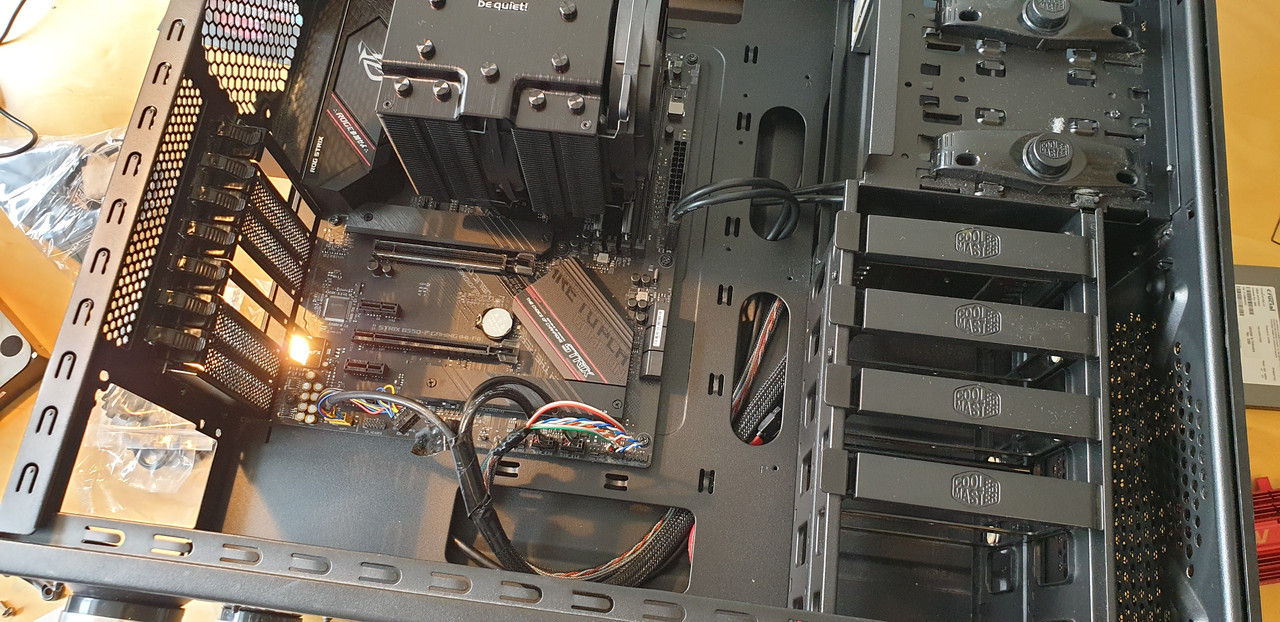

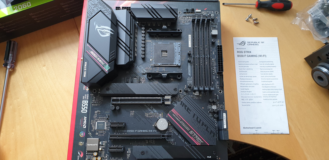

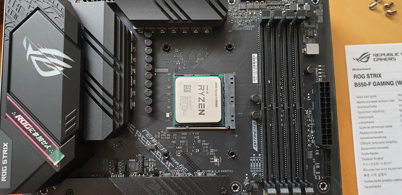

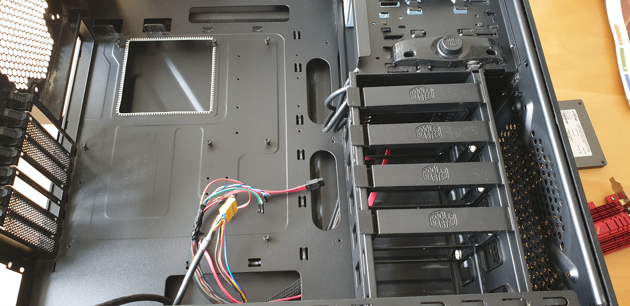

I pulled all the old parts (including fans) of out my computer case and cleaned it as best as I could.

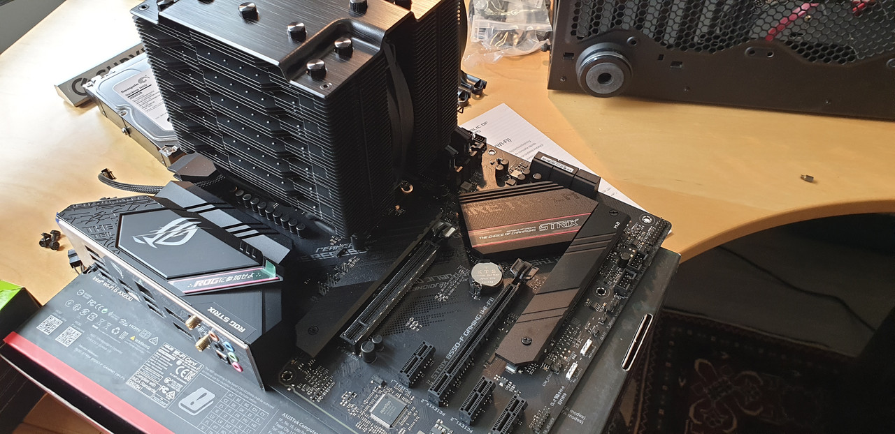

Motherboard:
CPU:
CPU cooler (Dark Rock Pro 4)

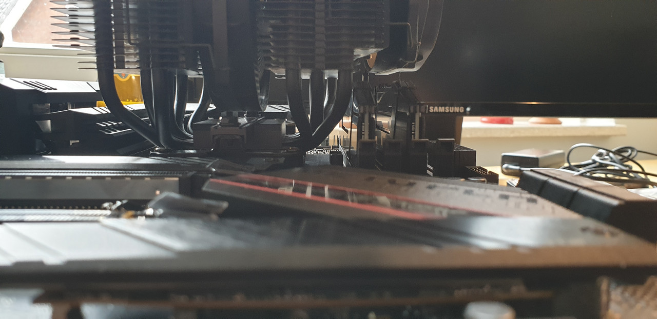

Just barely enough room with the RAM:

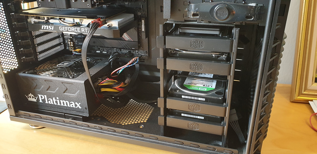

Power supply and GPU. I have the 1TB SSD (M.2) installed, but also added about 3TB in HDD from my old computer, they are still running so no need to replace yet.

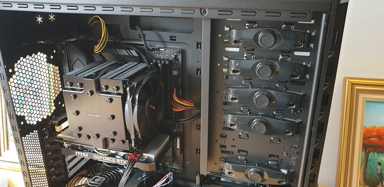

Still waiting on fans (want to replace my old ones), but the rest is all done.
