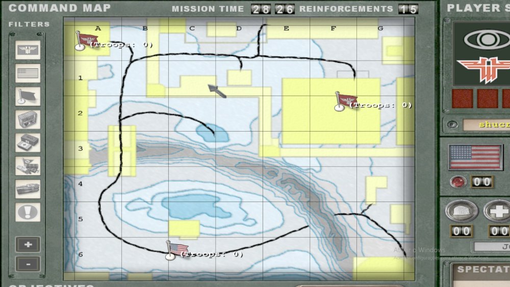

I changed the video card and now when I try to play with my cfg I get a bug in the resolution. My native resolution is 1920x1080 and when I put this resolution on the cfg the screen is cut in half. need help

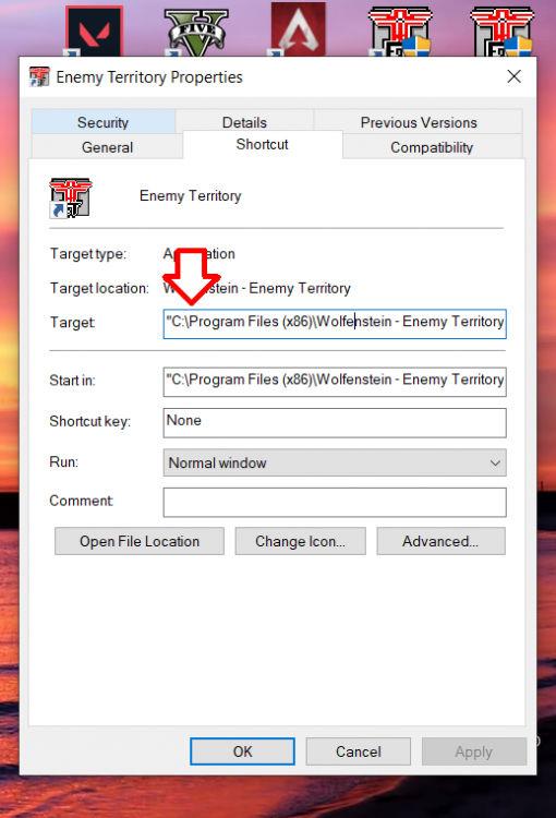

+r_mode "-1" +r_customwidth "1920" +r_customheight "1080"
or
+r_mode "-1" +r_customwidth "1600" +r_customheight "900"

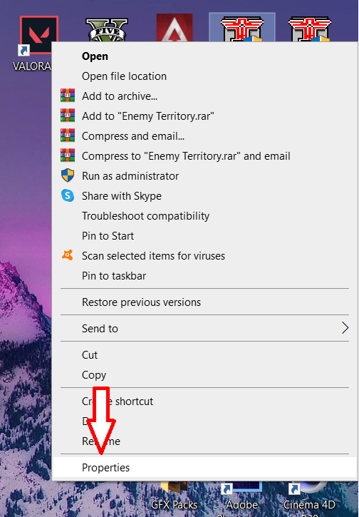

Right click your ET shortcut
You can type in/copy and paste the provided resolution above into there. I found that 1600x900 was best for me and pc.
Another note: you will need "r_mode -1" to run a custom resolution.
