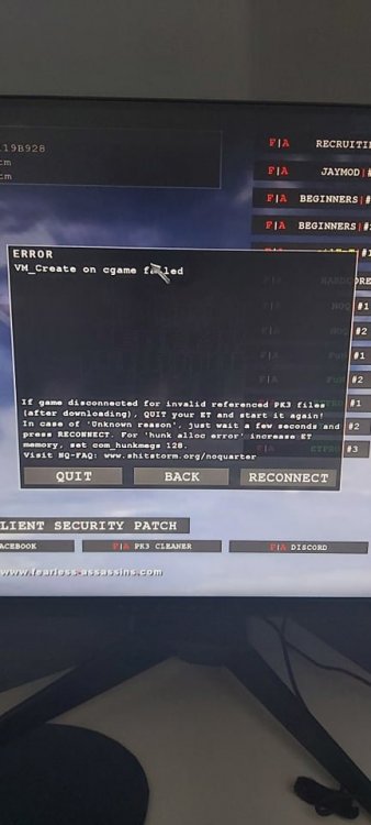

hello i have a problem i installed etlegacy and when i run it it will pop up error vm_create on cgame failed, i recently changed the graphics card to amd and also the new windows 10 thank you for the answers

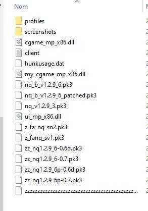

I use ETL 2.76
Here is what i have in my NQ folder :
I copied the dll files from my 2.60b installation.

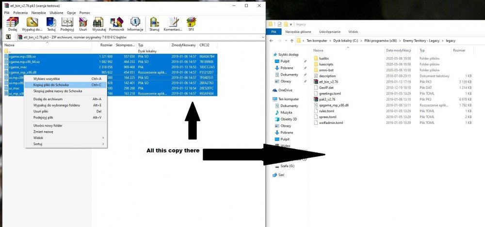

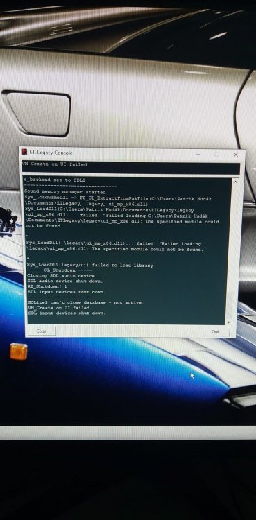

all you need to do is to unpack this files manually from etl_bin_v2.76.pk3 file (it's in Legacy folder, use program Winrar for that) to "Legacy" folder in installation folder
And to connect to NQ1 you will still need to do what I told you in my first post in this topic :)

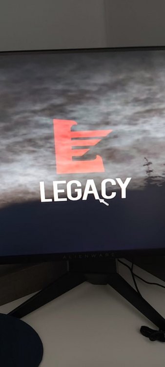

Hi, thank you for your answer, here is the overall problem with etlegacy not from nq, I tried it but without success still throws an error, although we have at least opened the app, but only this screen will remain photo
ok now try to do what I wrote in my second post and all will work trust me :D

etl_bin_v2.76.pk3 where can i download this?
look for it in Legacy mod folder
but here it is if its not there
etl_bin_v2.76.pk3

1. Try entering a command /seta com_hunkmegs 256 in console
2. If it doesn't work - delete all files in /User/Documents/ETLegacy/nq, download http://wolffiles.de/filebase/ET/Mods/nq_v1-2-9_b6.zip, open with e.g winrar or 7zip, put files nq_v1.2.9_3.pk3, nq_b_v1.2.9_6.pk3 and unpack the one I attached (again using winar/7zip)
