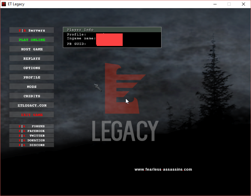

When I'm in the menu the custom Mouse Icon with the F|A is flipped upside down.  It's really annoying since I have to hover down and to the left and guess where the mouse pointer is actually clicking.  I cannot find the location of this in any of the pk3 files I opened.  Does anyone know where this is located?   I did a forum search and could not find anyone else with this issue.
This is a known issue with ETLegacy afaik. The solution would be to run "stock" ET.
I'm not sure which file exactly is our menu file, but I'd go for one with a bunch of tildes "~~~~~" or unicode blocks " " - it'd be located in your ETMain folder.
It's in ui/assets/ one of .tga files (3_cursor). Did you install etl and copied over old et260b files? If yes simply run etl ingame pk3 cleaner (should be available on legacy mod). I think I fixed the issue for our menus, last time I checked I had normal cursor when connected to our servers :)
I found the pk3 you mentioned, it indeed had the cursor.  All I did was flip it and save and now it's normal.  I tried to pk3 Cleaner but it didn't change.  Good to go, thanks for your help!

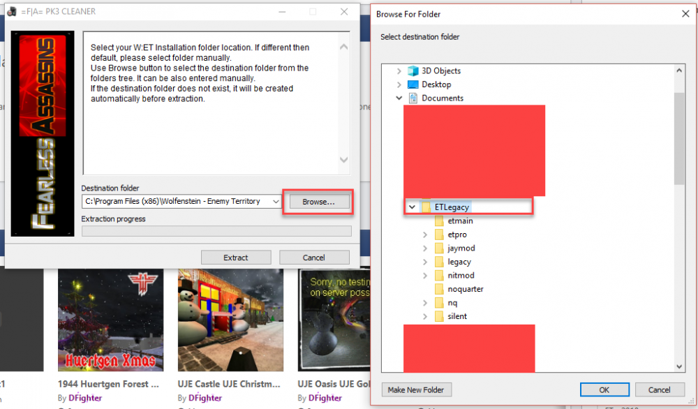

pk3 cleaner you need to run 2 times -
Once against WET folder installation and another time against - ETLegacy installation folder i.e.
C:\Users\xxxx\Documents\ETLegacy
Replace xxx with your login username for windows.
PS Assuming u are on windows.
Okay I only ran it on my Documents folder.  It did not fix the issue, I will try on the other folder tonight and see if that helps.  I couldn't flip the image in the pk3 since this caused me to get booted for invalid pk3 files.
  • Solution
2 cases then -
1. Either your folder selection is wrong.
2. Your pk3 cleaner version is old.
See below screenshots -
PK3 Cleaner may not be working properly because it can't download the server files for Jaymod on a new install of ETL it only generated the fav6.pk3
Restarting ETL installer multiple times on still no jaymod files just the fav6.pk3 even if it's installed to desktop
