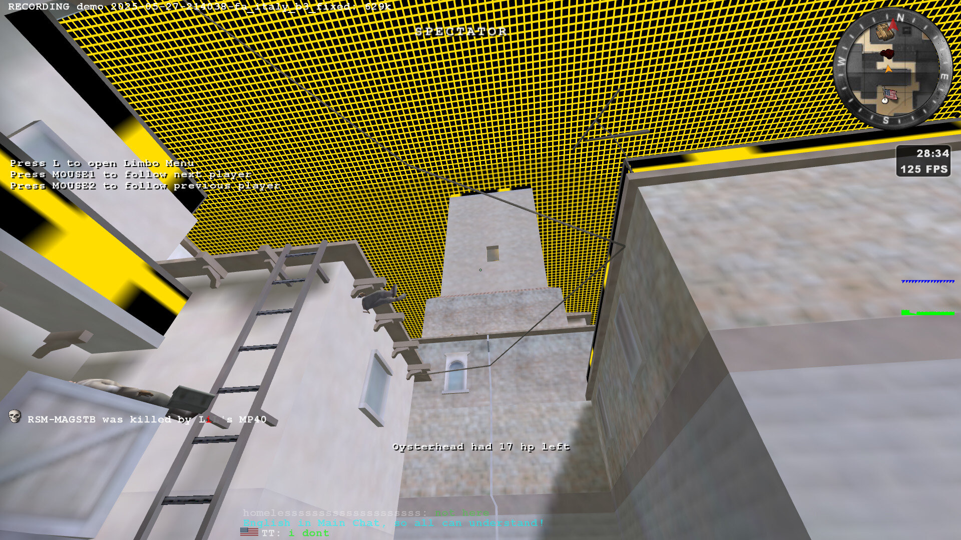

MosesIsComingLookBusy Posted Tuesday at 07:46 PM Posted Tuesday at 07:46 PM Had an issue with italy on Silent 1 just now: A few had the issue, while others did not. 1 1 1 Quote
Cocanation Posted Tuesday at 07:52 PM Posted Tuesday at 07:52 PM Finally i have a good reason to time out Italy for a while, i bet it's your fault @Drempa, thanksssss!!!! 2 3 1 Quote
Cross Marian Posted Tuesday at 07:57 PM Posted Tuesday at 07:57 PM 10 minutes ago, MosesIsComingLookBusy said: Had an issue with italy on Silent 1 just now: A few had the issue, while others did not. Did you try disconnecting/reconnecting to the server? Quote
MosesIsComingLookBusy Posted Tuesday at 08:07 PM Posted Tuesday at 08:07 PM (edited) 10 minutes ago, Cross Marian said: Did you try disconnecting/reconnecting to the server? Did a /reconnect, still same issue Edited Tuesday at 08:08 PM by MosesIsComingLookBusy 1 Quote
Shoresy Posted 23 hours ago Posted 23 hours ago In order to fix this issue with the missing skybox in Italy you need to locate the nuclear_delivery_b1.pk3 in your etmain>dlcache (if you have ETL) or just etmain for 2.6 and delete it. Once you delete the pk3 you should be able to reconnect and have no issues. Not to sure if anyone's posted this fix above, just wanted to repeat for the ones in the back row 2 1 1 Quote
Drempa Posted 23 hours ago Posted 23 hours ago (edited) 6 hours ago, MosesIsComingLookBusy said: Had an issue with italy on Silent 1 just now: A few had the issue, while others did not. just like shoresy explain, delete my map pk3 from your etmain. this issue would be fixed if map is removed from s1 untill i fix it and release fixed version which will no longer affect italy map. as long as map is in cycle this issue will occur everytime you download nuclear_delivery_b1,pk3 6 hours ago, Cocanation said: Finally i have a good reason to time out Italy for a while, i bet it's your fault @Drempa, thanksssss!!!! maybe it was on purpose Edited 23 hours ago by Drempa 3 Quote
