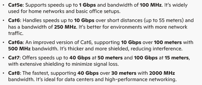

Sorry for the late response on this topic, but to get over 100Mbps, you need a cable above Cat5, at least Cat5e.
** Last two 7 & 8 are not usually provided for house services.
@tipsy --> So, if you ever upgrade for 1Gbps, make sure your total BW doesn't cap 100, otherwise you should change your current Cat5e to CAT6.
