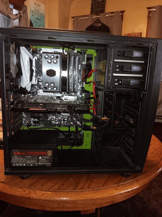

captnconcrete Posted December 21, 2024 Posted December 21, 2024 (edited) i got a aio from aftermath . with my cpu . and i looked up lots on em . my self i decided to go with a hyper cool master 212 black edition . yes when i took it out the box i was like dam thats a massive heatsink . if ur going to be overclocking and using ur pc at its max . then yes it might help . if not it wont be a issue with just a good heatsink and fan cooler. mine has impressed me with how well it cools cpu stays between 27 29 c.. also they come with a bunch diff brackets to mount it to ur mobo . its ur pc u do it how u want. if u do go with a water cooler. educate ur self on proper mounting. ive seen so many people not mount them correctly. with the cpu cooler i bought for my cpu .. i can also add a sec fan to the heatsink if i need to i thought that was neat! with a water cooler u most likely will have more room in ur case. a big heatsink takes up alot of room and might give some trouble with closing ur case or mounting a massive video card. or block ram slots. heres a pic of my cpu cooler. Edited December 21, 2024 by captnconcrete 3 Quote
