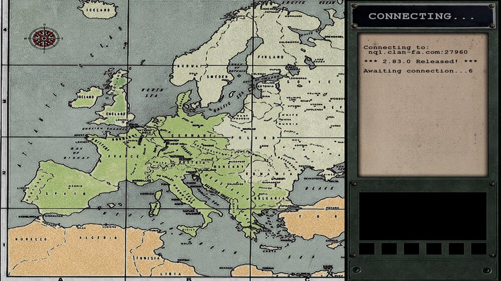

Now I'm getting the same issue as all you, I get stuck on awaiting connection, then awaiting challenge and finally on awaiting gamestate.
image.thumb.png.92f3b3e8ed00d0debeb4ed5a2ef42d2d.pngimage.thumb.png.a0bb2dc40d3f9b56168b801e431a368a.png
i have the same issues, but with some european servers. for example, nq1, fun2

 Is another "OVH US LLC "
:hmm It does not reach the FA server at all.
I am guessing that those "Private or Reserved or Undefined" ranges are used by your Internet Service Provider for internal routing.
1 hour ago, edsonmurta said:
JPanza here.
41 minutes ago, Caipirinha said:
Here is mine
Can you two try a WinMtr to jay2.clan-fa.com?   It is on the same machine as is Silent#1 and they might show a "normal" route to the machine.  :hmm
Jay2
|                                      WinMTR statistics                                   |
|                       Host              -   %  | Sent | Recv | Best | Avrg | Wrst | Last |
|                             192.168.0.1 -    0 |   62 |   62 |    0 |    0 |    5 |    1 |
|                               10.11.0.1 -    0 |   62 |   62 |    7 |    8 |   28 |    8 |
|                  b3e844f5.virtua.com.br -    0 |   62 |   62 |    8 |   10 |   16 |    9 |
|                   No response from host -  100 |   12 |    0 |    0 |    0 |    0 |    0 |
|________________________________________________|______|______|______|______|______|______|
   WinMTR v0.92 GPL V2 by Appnor MSP - Fully Managed Hosting & Cloud Provider
  • Surprise 2
3 minutes ago, Caipirinha said:
Jay2
Can you connect to jay#2?
Nop, cant connect either.
Can you call your ISP? Ask them why you can't connect to this IP? I am in talk with datacenter to see if we can swap s1 IP to different range.
Can u pls PM me your IP V4 as well?  https://whatismyipaddress.com/
I will do that!
I just PM'd  you my IP V4. Thanks DD!
