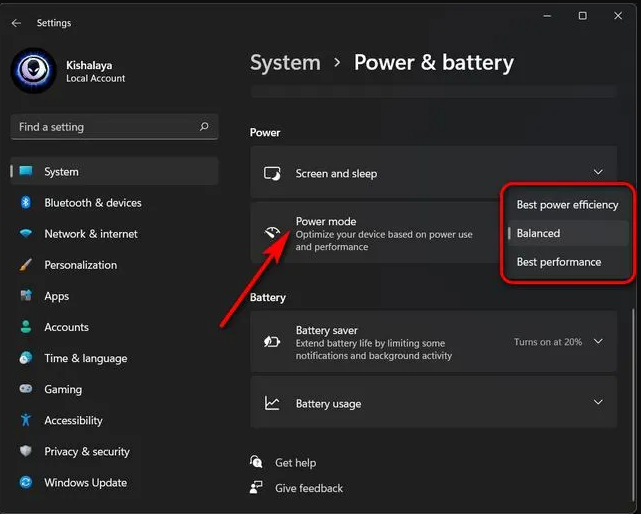

go to your windows power consumption settings and set it to  " best performance "
(image is from google )
Edited by Siwex89
