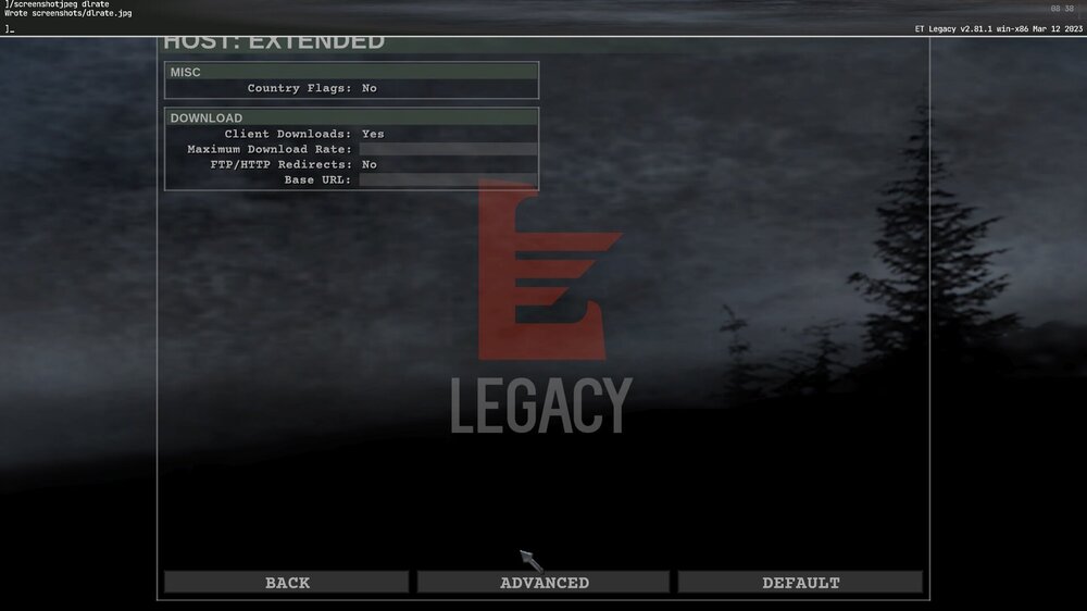

Have you tried to setup download rate here:
This should help:

You might want to increase below cvars on your server (ETL/2.60b may differ):
sv_dl_maxRate
sv_dlRate
It is probably in bytes. May be limited to 100kbps. Setting it to 0 might disable limit. Not sure about all that but it is something that you can check.

12 hours ago, RendeL said:
Hello and welcome to the forums.
I have not setup lanparty, but sounds like the redirect issue, since you say game is working otherwise.
if you limit it there, it can still just be limited between 0 and 100 Kilobits.
that made sense in some real slow or laggy networks, or when some shared their bandwidth, or your host was connected via an 56K modem or ISDN (128kbit) and you didn't want to blow the full bandwidth for map downloads.
