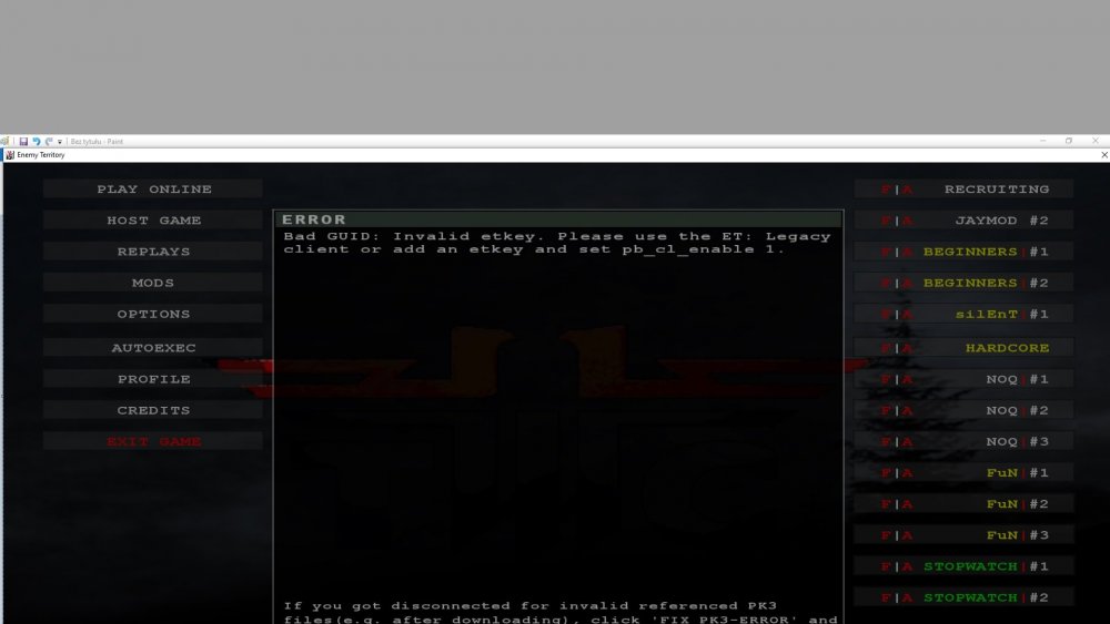

Hi there as asked by @Vasylich since he has the same kinda issue as I am as well.  Lately I have been visiting other =F|A= servers to welcome other players if I see some, and as of lately I have been trying to log on Nq 1 server via the server list and or connect to IP which I mainly do nq1.fa-clan.com:27960.  It acts like it wants to connect but goes to main ET screen with  error message saying "Bad GUID" Invalid Etkey so what I was wondering is there maybe a possibility that there is something wrong with the port because if I go to another server . ie jay 2 ,jay1, or silent then use FA's server list then try to connect to Nq1 then there isn't a issue.  Can someone please explain to me why this is??   Ty.

“Invalid guid” error appears mostly when you have no etkey in your etmain folder. Since Evenbalance stopped supporting ET, the “invalid guid” errors appears frequently, because while installing the game, it doesn’t automatically generate the etkey.
So, do this:
Go to http://etkey.net/ and click on “Get an ETKEY” button and download one, then unpack and copy it into your installed ET/etmain/ folder.
Remember: the etkey file doesn’t have any extension.
However you are able to join a server without the etkey, but there is a big chance to get kicked right away for “Invalid guid”.
If you already have an etkey in your wolfenstein etmain folder, then you just need to enable your punkbuster.
You can enable your punkbuster when you're in the server by these simply commands:
/pb_cl_enable 1 & then you just do /reconnect (All in console)

I think Dink should first look for ETkey in the "etmain" folder. If so, then he will have to generate a key from the site. If not, the problem lies elsewhere.
  • 0
I will also ask @Dink the Clown to run ET without mods. Then click on the "Play online" button. Then Dink should turn his eyes to the lower right corner of the monitor. There is a button that says "Turn Punkbuster On / Off". If Dink has a button that says "Turn off Punkbuster", then my theory has failed. If it says "Enable Punkbuster", then Dink needs to click on this button. Then launch the mod and try to connect to NQ1.

I have a similar problem with nq1 to enter. But I have to connect to nq2 first and then switch to nq1 and it works then  :)try to do this to enter nq2 first and then nq1. s1.thumb.jpg.f8231428db2a7616ad207bd39a04d98f.jpg
