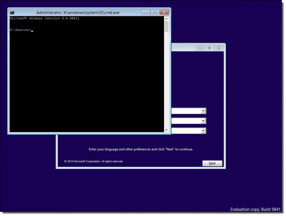

If you have UEFI in BIOS then - in Win 10 installer go to cmd console (Shift + F10).
You enter in turn (method 1):
1. list disk             (Opens the disk management program.)
2. select disk 0      (0 means the first disk, if your system is on another, select the appropriate disk.)
3. list partition     (Step 3 will not be needed as you are deleting all partitions and converting the disk to GPT format.
4. clean                (Erase all contents on disk and all partitions!)
5. convert gpt       (Converts disk to GPT format with MBR.)
6. exit                  (Actually you can turn off your computer without typing 6 and 7 points.
7. exit

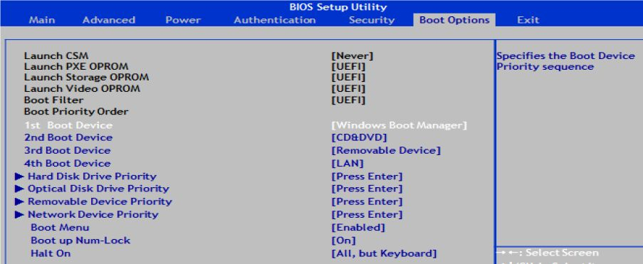

This is probably the BIOS of the Aspire TC-710 motherboard. I don't know, I don't want to look for it. Here you can switch the order of the disks. I start on the number one.
