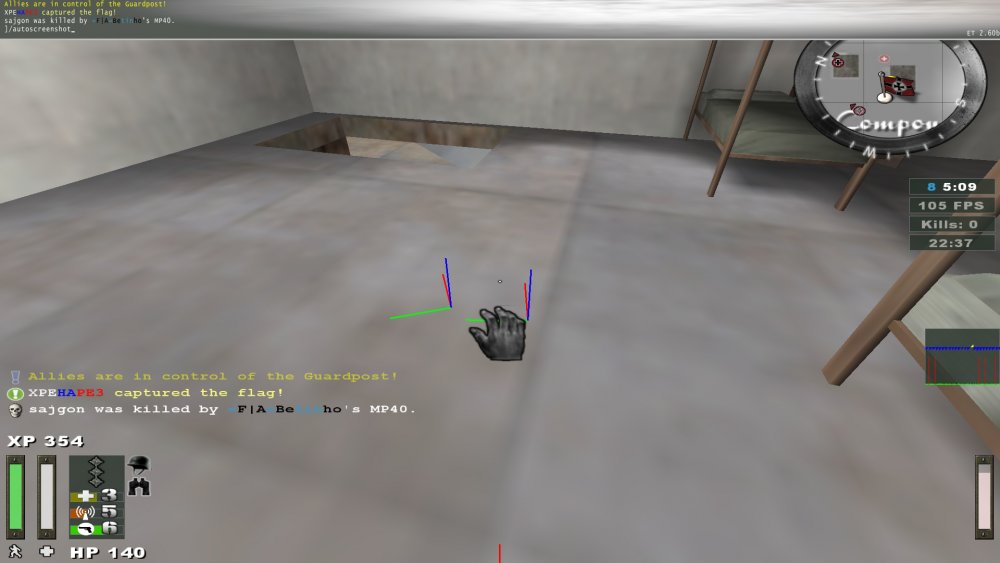

I am having problems on NQ1 lately. When I first connect I can see weapons and medpacks, ammo, etc but after the first map ends or I vid_restart (for example) those textures are not visible for me anymore and neither are hitsounds exceptfor headshots.
I tried deleting my entire modfolder and also the outdated noquarter folder but it didn't help the issue. I also used the pk3 cleaner but also to no avail.
In a similar thing, when I connect, if I exec my cfg, I get the exact same thing, so I have to do cvar_restart first, THEN exec my cfg to get clear graphics. That started about a year ago and I have never figured out what causes it

Some more info. I downloaded a completely fresh install and did not put a single cfg in the folder (as demonstrated) after receiving a failed pure server check error I turned on compatibility settings and have start-as-admin as a default (seen in the video). I connect to nq1 without issues but once I do a vid_restart my textures go away (and gunsound among few other sounds)
Exactly the same here! the last line of my cfg, of  course, is vid_restart which makes everything "milky" just as in your pic above. cvar_restart before my cfg fixes it, but it's a pain. on my old Logi Keyboard, I just setup G-Key macros that would run both scripts with one key. I can't figure it out on my Corsair Keyboard. (I can set the macros but they don't do anything in game)

I used a clean install and opened the game on stock settings, stock config and the same happened. But I still think it is somehow client related. In the video when I do vid_restart you see that the textures are all messy in the loading screen. This happens on every server. But the missing textures are only on nq. So if the weird loading screen is related to the missing textures it cannot be serversided really, it has to be clientsided

I've seen this before when creating a new map, if the textures aren't there you get the yellow/brown default and entities are displayed as a xyz coordinates lines
why this is happening to you on a fresh install is a headscratcher tho
as its only NQ i suspect there's a bug/glitch in the NQ folder (or some old custom skin pack lurking somewhere or something like, even though fresh install should eliminate that)
