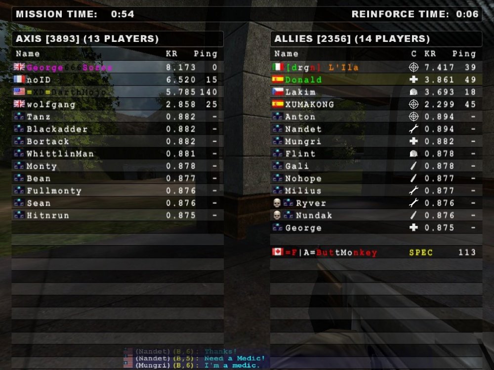

It seems I will only be able to play at nights more than 2 am... I enclose photo of my ping at 02:15... just 49
15 minutes before. over 500
