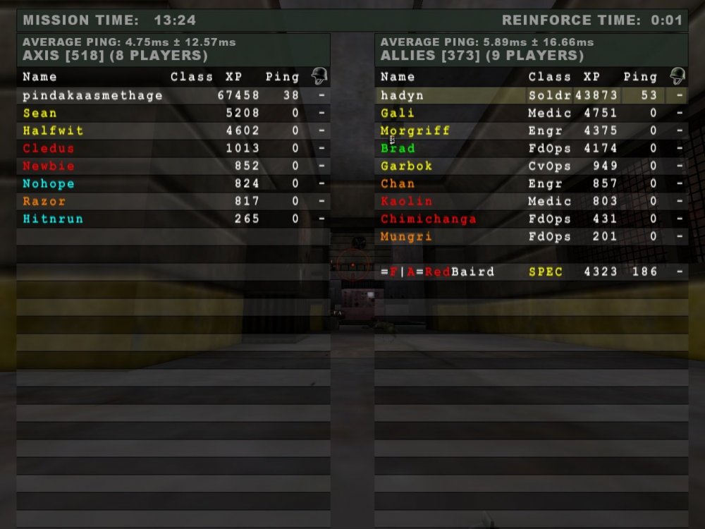

Seen right now on Beginners#1 / Jay#3 :D
yes that error failed pure server check is 99% of the time
the persons not running game as admin glad it's straightened out :)
