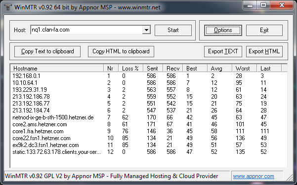

I'm getting some weird lagspikes when I play (no matter on which server). I get lagspikes every 30s-few minutes. I wonder if there's some connection problems..
Here's MTP result
I don't remember if I had any lagspike issues when I played years ago on other clan's servers. Ever since I tried again (Both ET and ETL), I've got these weird lagspikes.
500 packets will not help in this case. Our Euro datacenter just want to be jerk to their customers cos some customers raise issues over 10 packets so I don't blame them either. Hence they ask for 1000 packets.
To find issue, run for 100 packets. In conjunction of winMTR use https://www.pingplotter.com/
It will tell you on which hop your latency spikes. To me - first hop - your worst is 28, then 2nd hop 95. All those worst on initial hops gets carried forward.
