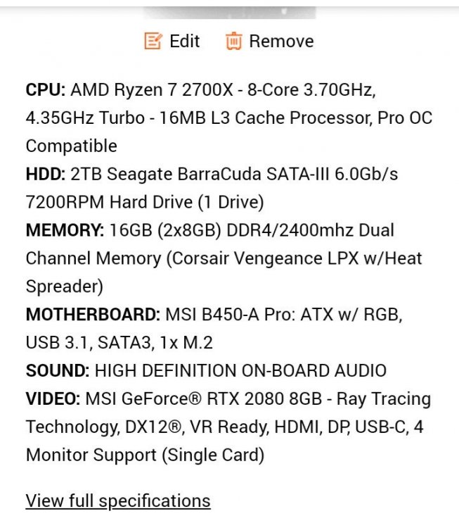

HOTSPUR Posted April 24, 2019 Posted April 24, 2019 Can anyone let me know what needs adding or changing for high gaming performance. ? Quote

Vanaraud Posted April 24, 2019 Posted April 24, 2019 Some1 have to QVL the memory, maybe aim for 2666Mhz+ RAM, Hynx should have some well priced, well clocking sticks out by now. Too lazy to check for part nr atm...Maybe: https://www.amazon.com/HyperX-Predator-3333MHz-Desktop-HX433C16PB3/dp/B07GNFKKHP?th=1 from here https://www.msi.com/Motherboard/support/B450-A-PRO#support-mem-14 oh and add SSD, XPG 8200 should be good perf\buck. 1 Quote
Snuffs99 Posted April 24, 2019 Posted April 24, 2019 (edited) Nice, pretty much what i have although i'd rec using either the 250 or 500GB Samsung 970 evo for your OS install (might as well use that M.2 slot)...nothing really touches it speeds wise and mine runs very well. Edited April 24, 2019 by Snuffs99 Quote

HOTSPUR Posted April 24, 2019 Author Posted April 24, 2019 I'm hoping not to get another pc for a least 5yrs,so hopefully this holds up, well it better for the price. Quote
Snuffs99 Posted April 24, 2019 Posted April 24, 2019 1 minute ago, HOTSPUR said: I'm hoping not to get another pc for a least 5yrs,so hopefully this holds up, well it better for the price. Haha that was my thinking too, i built mine for my birthday at the end of January and love it mate (nice to see the bios date as 2019 rather than 2012 like my older mobo) so you will no doubt love yours, bit envious of the 2080 mind as i could only afford the 2070... but can certainly play anything i throw at it on ultra settings etc etc. Quote
HOTSPUR Posted April 24, 2019 Author Posted April 24, 2019 2 minutes ago, Snuffs99 said: Haha that was my thinking too, i built mine for my birthday at the end of January and love it mate (nice to see the bios date as 2019 rather than 2012 like my older mobo) so you will no doubt love yours, bit envious of the 2080 mind as i could only afford the 2070... but can certainly play anything i throw at it on ultra settings etc etc. That's good to hear, I've gone ahead with this, now have to wait up to 10 days for it to be put together and delivered. Quote

Platinum VIP Aftermath Posted April 30, 2019 Platinum VIP Posted April 30, 2019 Agree with the RAM speed comments. A friend of mine has a 2700X build and recommends 3000mhz+ Quote
HOTSPUR Posted April 30, 2019 Author Posted April 30, 2019 3000hz is done ? Now to tell the misses ? Quote
