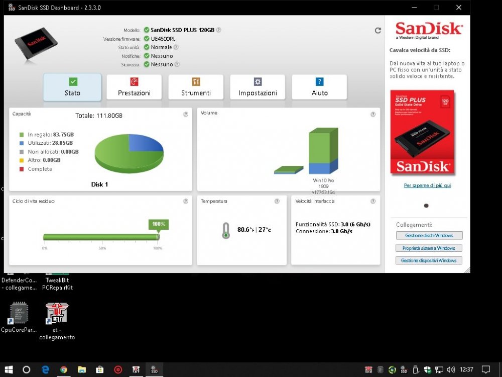

I'm unlucky because my motherboard takes only half the speed of the Sandisk SSD PLUS 120gb 3GB / 6GB SATA III
it works at 3GB

I think the problem is that your motherboard supports only sata2 and you need sata3 6Gb/s connectors to run those ssds at full speed
Like Siwex89 said :
Values from Asus:
  • Intel® LGA775-Plattform
  • Unterstützt 45nm-Prozessoren
  • Intel® G31 + ICH7-Chipsatz
  • Front Side Bus-Overclocking mit 1600(O.C)/1066/800 MHz
  • Dual-Channel DDR2 1066(O.C.)/800/667-Unterstützung
  • PCI Express™ x16-Architektur
  • Realtek® PCIe Gigabit LAN inklusive AI NET2
  • 4x SATA 3Gb/s-Schnittstellen

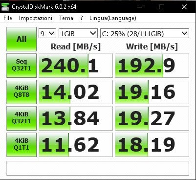

in fact, the reason for my disappointment is on the assembled pc, because the laptop has the sata3 port, and the 6GB / s connection works

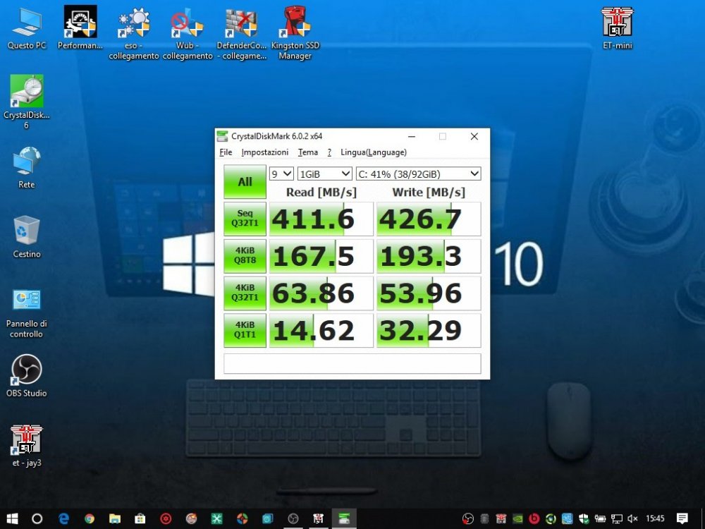

try AS SSD Benchmark or crystal diskto have a look at the speed. Maybe everything is ok image.png.05597afb424d61779635b2082472c00e.png
Picture is taken from Amazon from Kingston SSD 240 as a hint.
Edited by Smoky
the fixed pc with connection 3 GB / s
something is wrong, but I'm using the computer in other operations, I do not think is reliable
I now run the test on the laptop, while I run et, and with obs enabled in streaming
good
Edited by JirenTV
