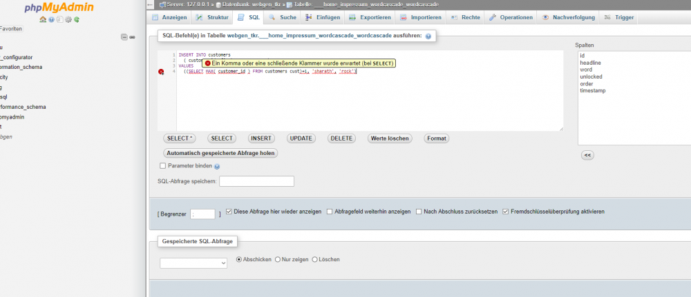

This one does not work anyway - see screenshot.
Cannot imagine that post getting 9 points up without working on syntax. Either I do sth. wrong here or nobody tests the code before rating up.

Thx for reply as well.
Unfortunately the syntax appears to be invalid in PHP myAdmin again ?
the english msg like: a comma or a closing bracket was expected (at SELECT)
I really wished that would worked that fast ?

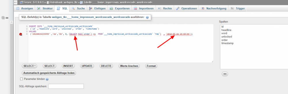

I tried adding this record, and it worked in my phpMyAdmin:
INSERT INTO `___home_impressum_wordcascade_wordcascade`
 (`id` ,`headline`,`word`, `unlocked`, `order`, `timestamp`)
VALUES
 ('20180826235955' ,'aa','bb', 0, (SELECT MAX(`order`)+1 FROM`___home_impressum_wordcascade_wordcascade` `tmp`)  , '2018-08-26 23:59:55');
"order" needs to be in quotation because it's a MySQL parameter.  You could rename it to "sort_order" to avoid having a column named as a MySQL parameter.
I also had to change the type of "id" to bigint.

Oh, sry about that - in the original source it was quoted ...
But now we are a step in the right direction ... I submitted your code and it worked for the first time but highlighted as errors - see screen. This is terrifying.
But when I submit the code the second time, i get errors. I changed the "NULL" in order to 0 before to be sure:
Static Analysis:
10 Errors.
  1. Ein Komma oder eine schließende Klammer wurde erwartet (near "SELECT" at position 165) //expected comma or closing bracket
  2. Unerkanntes Schlüsselwort. (near "MAX" at position 172) //unknown keyword
  3. Unerwartetes Zeichen. (near "(" at position 175) //unexpected sign
  4. Unerwartetes Zeichen. (near "`order`" at position 176)
  5. Unerwartetes Zeichen. (near ")" at position 183)
  6. Unerwartetes Zeichen. (near "+1" at position 184)
  7. Unerwartetes Zeichen. (near ")" at position 240)
  8. Unerwartetes Zeichen. (near "," at position 243)
  9. Unerwartetes Zeichen. (near "'2018-08-26 23:59:55'" at position 245)
  10. Unerwartetes Zeichen. (near ")" at position 266)
