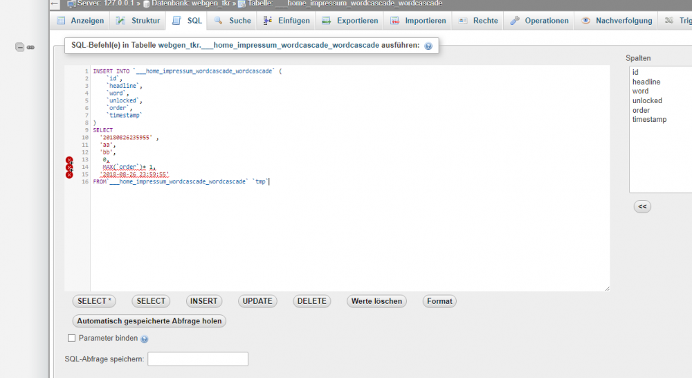

Sry, too did not get the msg before I fell to sleep .... it was 5:30 AM here and I thought the day was long enough...
This doesn't work anyway .... the Syntax-Highlighter is driving me crazy so freakn hard.
But why SELECT before '20180826235955' ?

No problem at all.
You can give a default value to a SELECT.  So if you SELECT '20180826235955',  you force the first value of the SELECT query result to be '20180826235955'.
There must be something wrong with your phpMyAdmin settings since it's working perfectly in mine.  Can you try running this query in your PHP code to see if it works?

12 minutes ago, ChaOs said:
I have a thought about that the second entry did not work ... because primary & int(255) ... so you get a collision because the biggest possible int (2147483648) was taken two times (the datetime-string is bigger than int255). Maybe that was the reason last time ... but the freakin' syntax parser everytime underlines that ... i'll try your method out again later, because first I tried the lock-version as I got the int problem this time and made the id simply double.
In the table I created for testing the query I gave you, I had to change the id INT to BIGINT and it worked.  You could try with another id value, of course.
Yeah. But until I got that the id tried to be similar in this case I had to try the lock-version, because the syntax parser in my PHPmyAdmin, as u saw, everytime cried. So it was nearly impossible to fix up other errors which I didn't see by myself.
Now I go on testing the code by your select max version.
