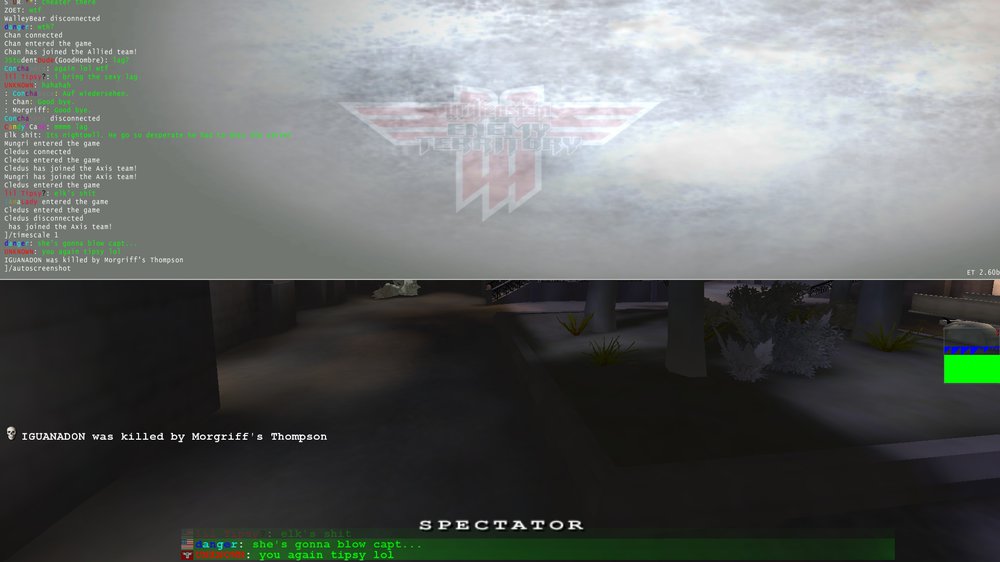

Post a winMTR 100 packets and a screenshot of your lagometer :)

screenshot taken from demo.
everyone was lagging
