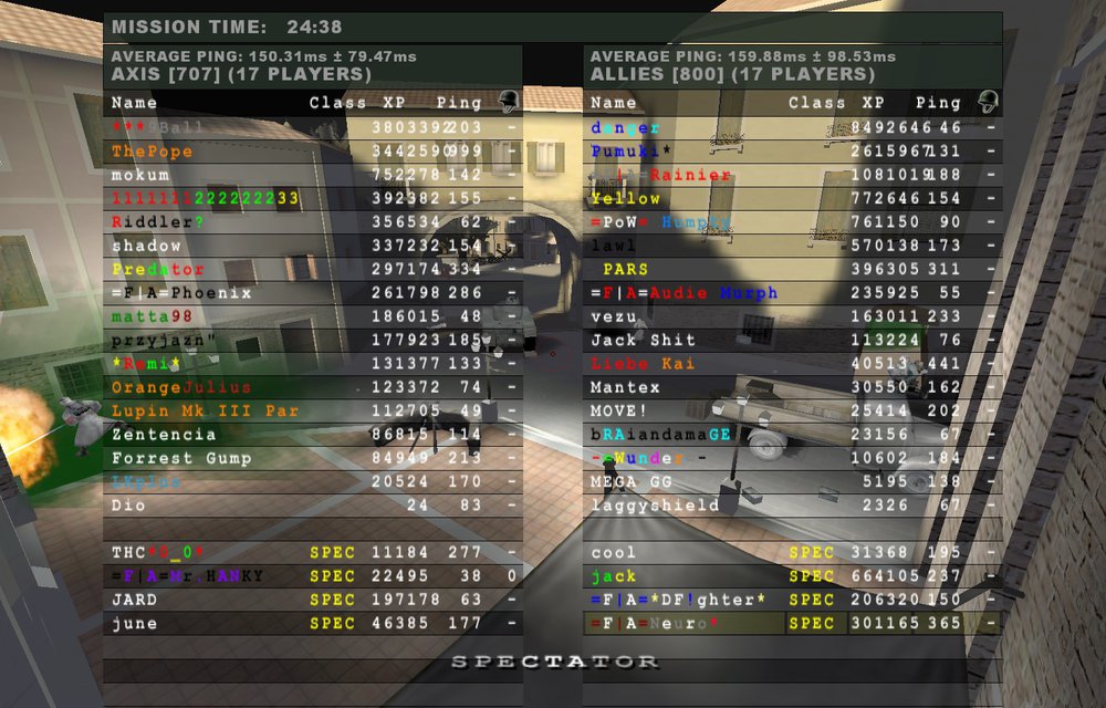

Hi- Lately I've been having issues with my ping. It either spikes or stays wack for a period of time. I'm using wifi. It could be my internet connection so I'm calling tech support tomorrow.
I restarted the modem and it didn't help.
Is it possible that ping is better on certain maps than others? Cuz I thought it was working alright on fuel dump but not bba0-beta2 or venice.

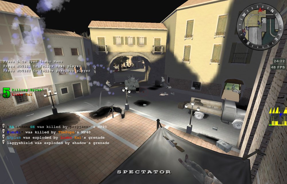

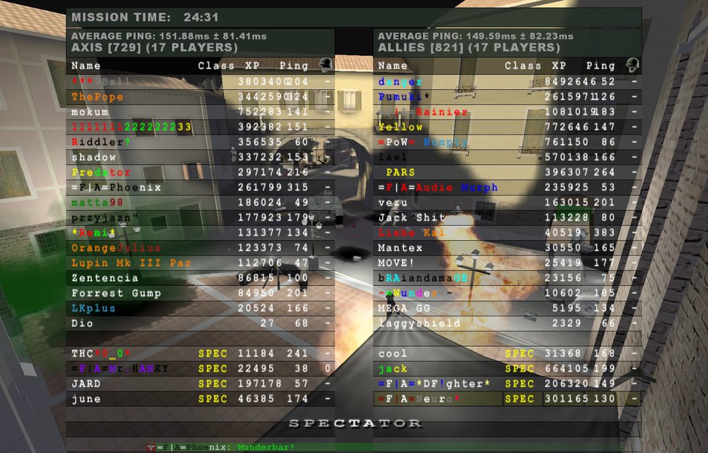

Maybe someone here can notice something from my lagometer and ping. Here are the ss:
2018-04-15-122347-venice_ne4.thumb.jpg.b61e9ec89df7188f631b355c7e0c4dca.jpg2018-04-15-122353-venice_ne4.thumb.jpg.1c1318b98052aec822e9015da08f632d.jpg2018-04-15-122402-venice_ne4.thumb.jpg.694febe0bd2b88be1a99ef6adb7794e7.jpg

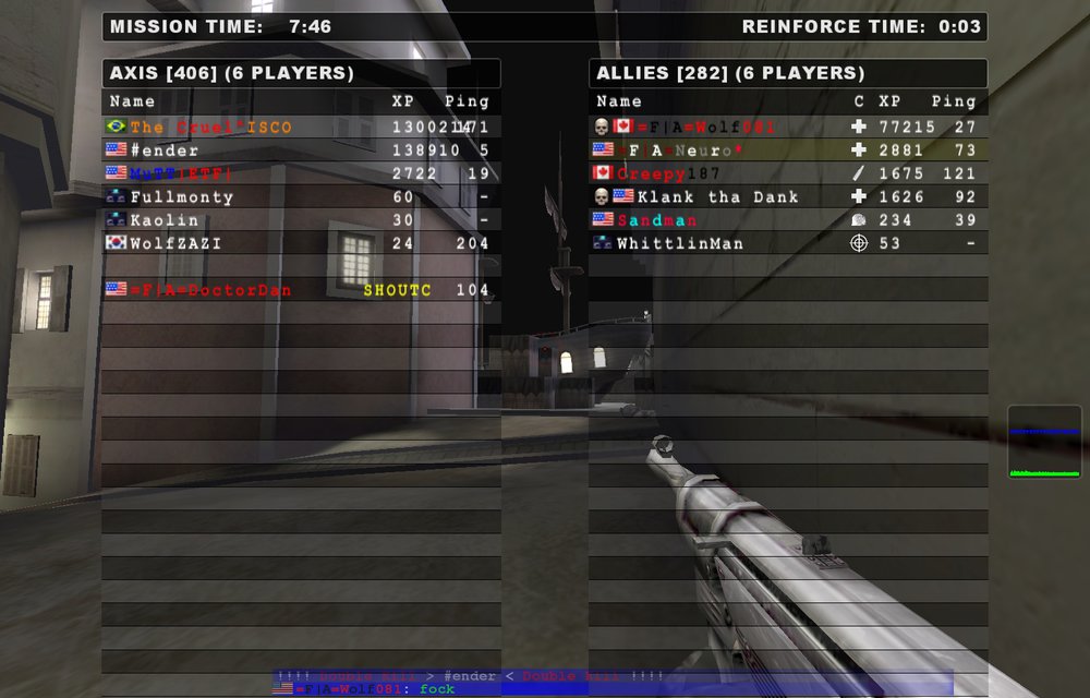

 More stable ping/connection on hardcore:

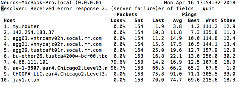

@daredevil
5ad50d8f51e39_ScreenShot2018-04-16at13_54_28.thumb.png.ea25d50782b20d5eceb0e82161085c8a.png
Edited by Neuro
  • 0
Despite resolved error - u router is in bad shape. StdDev of anything above 10 is bad when you have consistent ping replies.

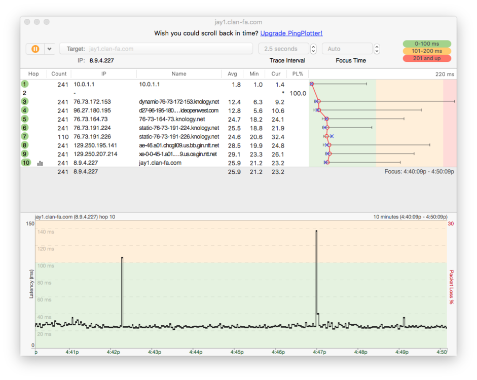

Try this one for more in-depth analysis for one node -
https://www.pingplotter.com/download/macos

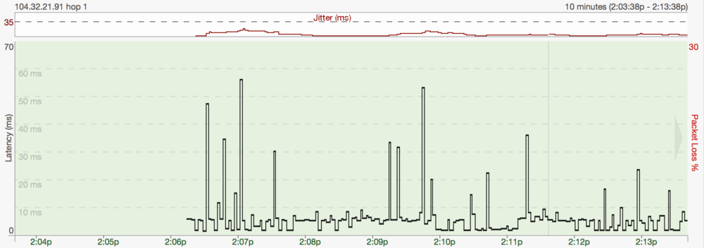

@daredevil Idk what I'm looking at but it's a pretty graph. LOOK at my lovely (partially sarcastic) GO:
5ad512cf68267_ScreenShot2018-04-16at14_13_24.thumb.png.8bea376d69fddca60d84c995a7f3ac4d.png
