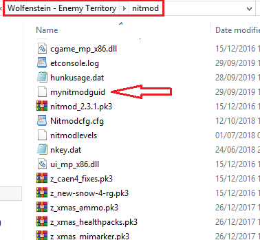

Alternatively, you can condump it into a .txt file.
2. Type /clear in the console to delete the contents of the console
3. Type /n_guid - a string of numbers and letters will appear.
4. Type /condump mynitmodguid to save your GUID into a .txt file.
5. Go to your wolfenstein folder ----> Nitmod folder and search for the .txt file named "mynitmodguid".
6. Open it in notepad or a word document.
7. Go to your profile and click Edit profile.
8. Scroll down until you see a heading called N:ET. Copy and paste the last 8 digits from the .txt file into the empty field.
9. Click save.
Congratulations, you have now updated your profile with your Nitmod GUID.
