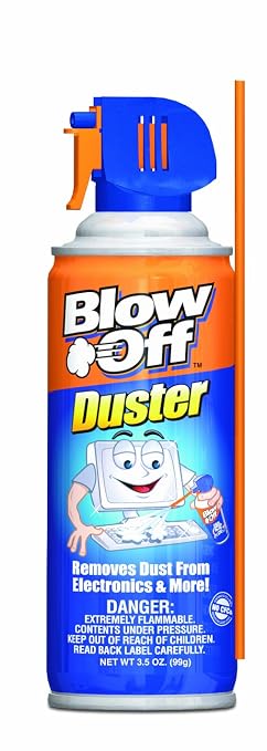

Hi Archon,
what i have at home are cans filled with air:
http://www.amazon.com/s/ref=nb_sb_noss_2?url=search-alias%3Daps&field-keywords=can+of+air
They usually have a little straw that makes it easy to get into the fan without disassembling your laptop.
However it will have a better affect when you open your laptop and clean it with air pressure, because you get more dirt out and can target dusty areas easier.
