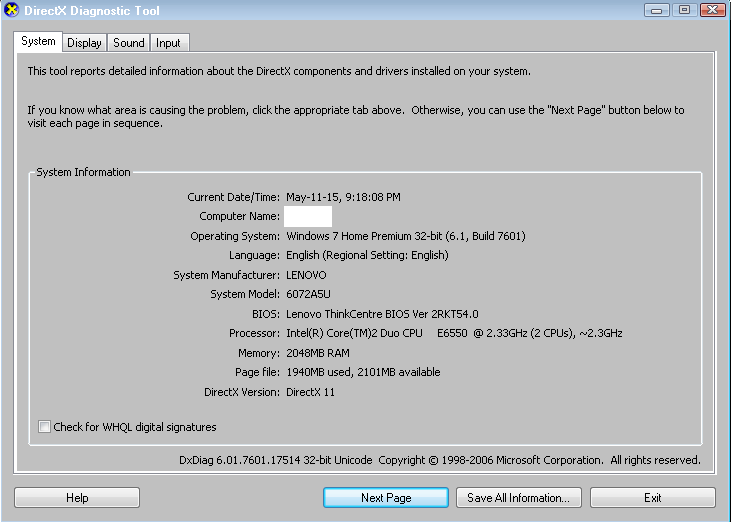

Okay here is a screen shot of my specs, including my module name. I already knew how to find the watt usage of this computer, but thanks anyways :D

And to Xern, I found the watts my motherboard uses which is 99.4 - 119.3 W (depending on clock speed). Also my motherboard is called Lenovo ThinkCentre M57, pretty old so it might affect what graphics card I'm going to buy.
