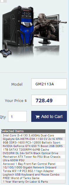

What about this one?
I think I'll probably buy this computer for myself since somebody is gonna give him a computer too lol
The cyberpowerpc is really nice! for the Money.
Although the videocard is low-end($55), It's not bad.
I wouldn't buy the CybertronPC Patriot.

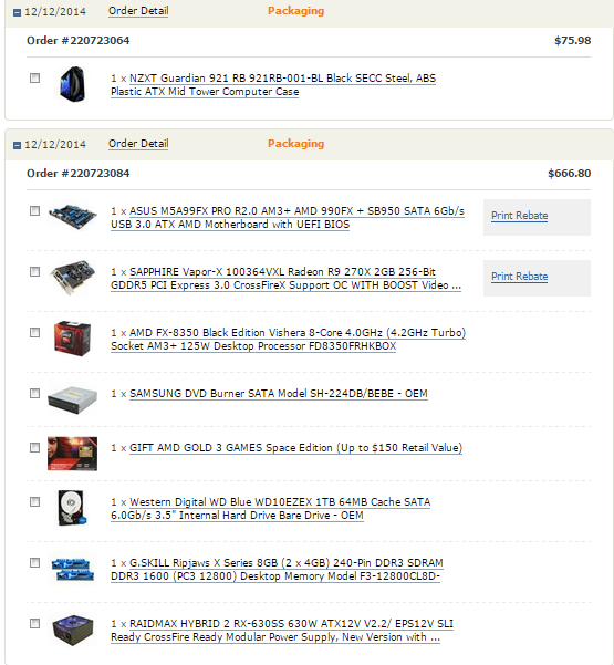

So this is the computer I bought, you guys convinced me to build my own. I will need your advice for building it because I have never done this before.
I used https://pcpartpicker.com/  to check compability for these parts.
Thanks a lot family!

Your build looks good also but I´d cut down from mobo and case and put more in GPU: r9 280\285 would be nice.
In gaming graphics card is most important, for instance even on Ultra settings my old IB i5 3570 runs 80-90% usage but r9 290 GPU is under full load the whole time. In gaming i3 and FX 8350 are at same level, but AMD CPU-s consume more energy, so you´d have to use aftermarket CPU cooler or deal with more noise.
Let´s set new budget to 700$ as I see on your build, got 680$ in newegg with rebates:
EDIT: Anyone heard about Raidmax PSUs? I´ve not, better take some good Seasonic or Corsair CX\RM are fine too.  Personally I´ve got good experience with Chieftec also.
Also I´m afraid that this case is too expensive for what it is and has not enough room to fit graphics card, and cheap interior finishing, no USB 3.0 on front panel.
What I´m looking for these days from case is: USB 3.0 on front panel, clearence for CPU cooler(about 160mm is enough) and support for long GPUs- even 270x is almost 300m long, so case should fit about 315\320mm GPUs.
