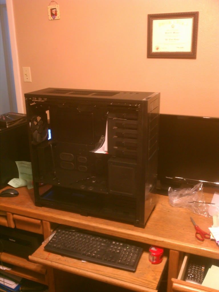

Empty case, new monitor behind it, old keyboard still on the tray.

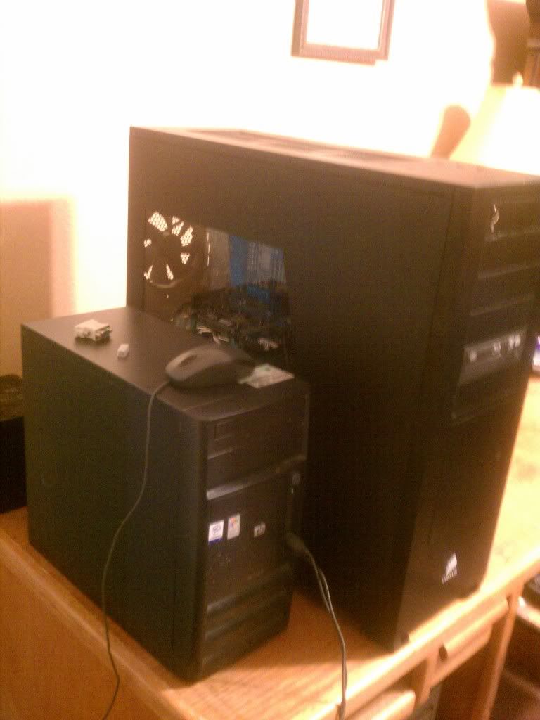

Supercomputer next to my old dell (now my daughters)

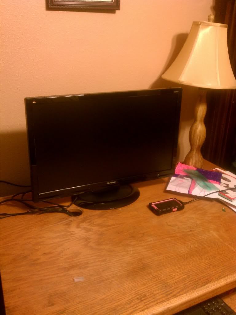

new monitor is 27 inches, old crt was 14.

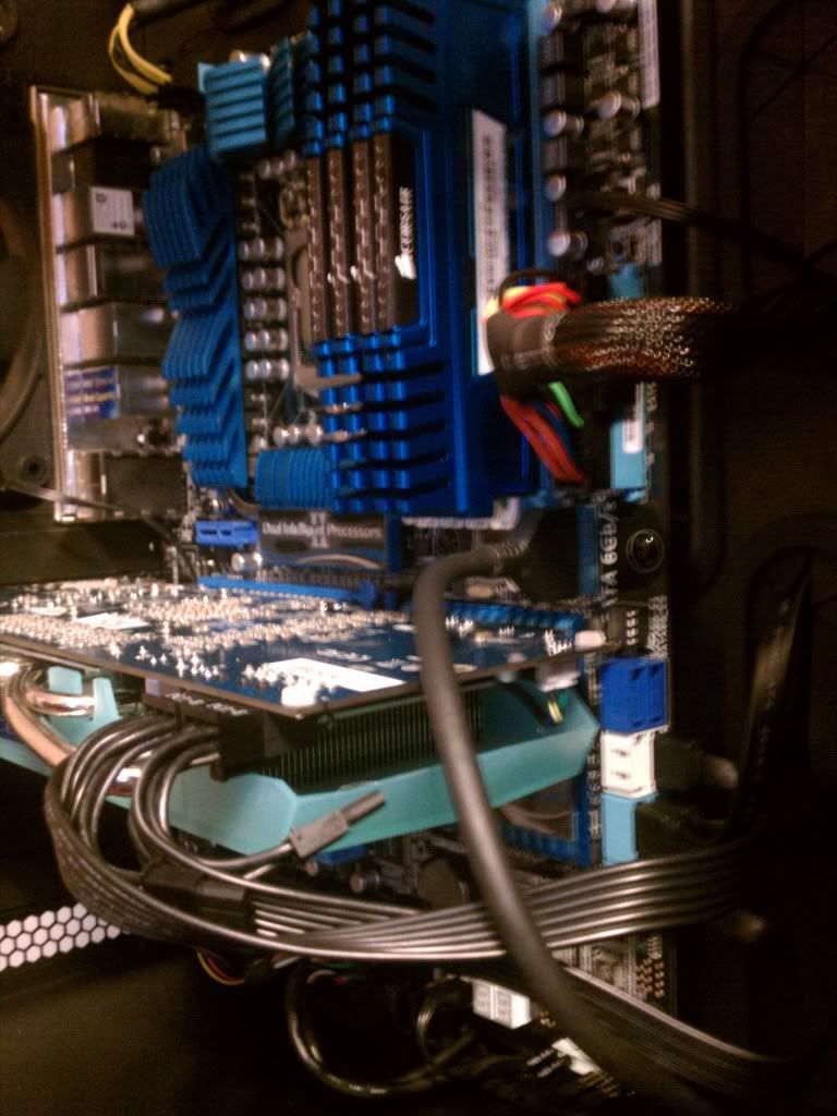

close up of ram/gpu

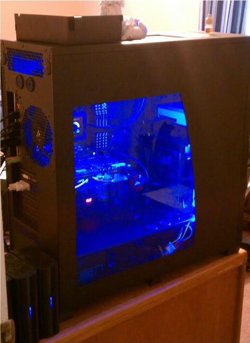

fully built and running.
after adding a coupla cold cathodes...

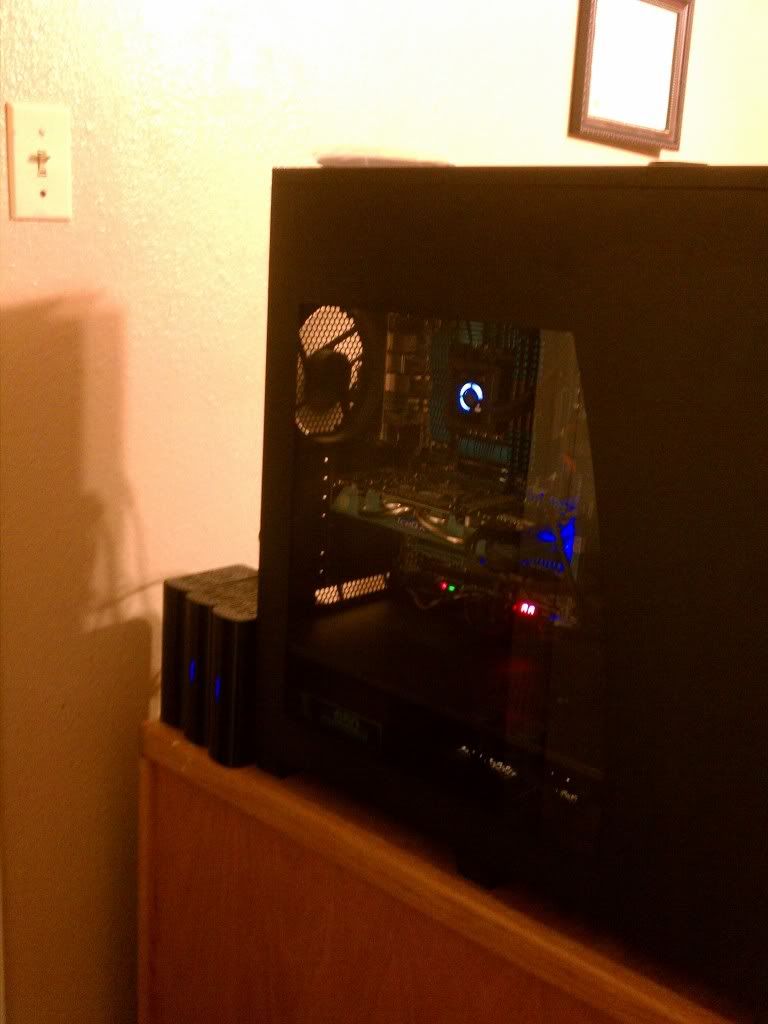

Complete specs:
Corsair 800D case
Corsair HX650 power supply
Asus Deluxe P8Z68 motherboard
i5-2500k overclocked to 4.8GHz
Corsair H100 water cooler
16 GB Corsair Vengeance at 1600MHz
120 GB Kingston HyperX SSD
3 TB Seagate Barracuda 7200 rpm storage drive
HIS IceQ 6950
Lite-On bluray burner
Viewsonic 27 inch monitor
Logitech G110 backlit keyboard
Logitech G500 mouse
Logitech S-220 2.1 speakers
Plantronics Gamecon 377 headset
also have 3 externals behind the computer, totaling 2.5TB of additional storage
Oooo Ahhhh nice blue lights.. I went for the purple ones :)

homebuilt. Extremely satisfying, first time building one.
HIS 6950 video card. Runs BF3 on ultra, avg 30fps. On high it's smooth as butter no matter what.
The overclock has been stable so far, temps max at around 68-74 under torture. I had it up to 5.0, but it was pushing 90 and I got scared. Funny sidenote, I got greedy and tried to flash the 6950 to 6970 firmware. Figured, all hell, why not, i have dual bios! what could possibly go wrong? Flashed, and after reboot....blank screen. no post. Went hunting for bios switch. Discovered my HIS 6950 was not reference design. No switch. Screamed in anger at mt stupidity. RMA'd bricked card. learned powerful lesson. pigs get fed, hogs get slaughtered.
