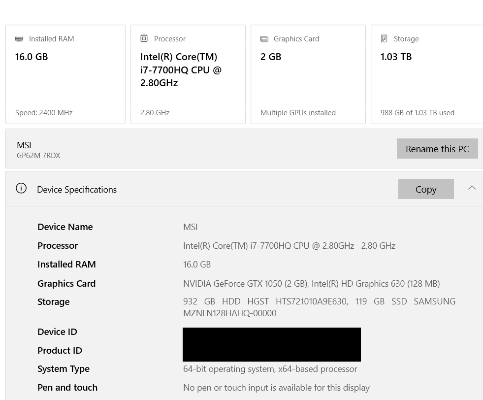

laptop  specs/ brand model  . gpu  drivers?
and what o/s .

AFAIK my mobo is still the same as it has been, I've not touched it or been in bios.
Onboard gpu, I've toggled off via settings and chose my 1050 as my main a few years back. Could it be somehow its trying to run off the intel or both? I've never had any issue until my new keyboard and moving... how can I check if its running on a single core?

Hi Blade; if you have had no problems since you got this laptop until now, check if what you are experiencing now is not due to problems with the CPU/GPU overheating in certain situations.
Maybe the fan is not spinning enough, some thermal pad or thermal paste needs replacing, the air intake opening could be semi-obstructed by something?
Also, the latest versions of Nvidia drivers in some cases create problems instead of improvements; in this case my advice is to use:
Nvidia Studio Drivers instead of GamesReady
NvidiacleanInstall for debloating (on YT there are videos on how to do it and why)
DDU to clean the system and reinstall the drivers with debloating
As an example I link you to the video in Italian

I’d agree, based on the way the topic reads. It has a high likelihood of being thermal throttling. I’d do a basic disassembly and clean out any dust, as well as repaste with some good old Arctic Silver.
