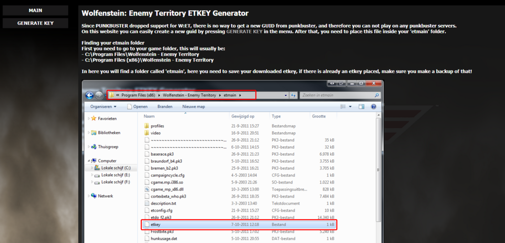

- Check your etkey located within the etmain folder (This is commonly located at "C:\Program Files (x86)\Wolfenstein - Enemy Territory\etmain")
- Verify that your etkey is valid. When you open the file, it should contain a string of alphanumeric characters. If the file is empty, has unusual characters, or doesn’t look like a proper alphanumeric string, it might be corrupted.
- Ensure to backup your current etkey. This way, if you need to restore it later, you won’t lose your current XP.
- If your etkey appears valid, try reconnecting to the server. However, if you still have the same issue, you might need to try deleting the file and reconnecting to the server. We can guide you through that, but having the backup means we can try to restore your previous XP later if needed.

After reading this post.. I took a look at my ETKey file....
I also had weird characters in my ETKey and I was also getting the Invalid user information in game, but it was allowing me to continue to play.
Here is what I did to correct...
Make a BACKUP of your existing etkey file... before doing anything.
Your original etkey should be the FIRST 28 Characters .... could be alphanumeric... mine was all numbers.
I just deleted all the junk after the 1st 28 and saved the file as is...
Tested just now and working still, no more error message and luckily my XP restored from yesterday.
... maybe I got lucky.
Hope this helps.
I did also go to www,etkey.net and generate a new key download to see what its syntax was... the new one was all numbers as well.
You may need a new key... in that case you will most likely lose your xp... sorry
Good luck and hurry back...
The "original" etkey files downloaded with the original ET installations also had a data-line with 28 decimal digits, followed by Non-Text 'binary' characters.
The etkeys that we get now, either from an "etkey generator", or auto-downloaded from FA servers (Jay, NQ and ETL?) when the server finds no etkey file in ETmain, only have a 28 digit decimal number in them now, with no trailing binary codes.
Something like the line below used to be in the original ETkey files.  It always followed the decimal numbers in the data-line (in the original PunkBuster-source etkeys).
GAc*±nø~@Ie+¯fúgjÁOeÆxlÞInÎr@Ac ·wè
If you still have "original" etkeys, then this is normal.  I think that the PunkBuster module might have generated them, way back then.
If the Binary is leading the decimal numbers then there is a problem!  😄  (I think that perhaps I shall experiment! 😄 🔥 )

Okay, "wiki.archlinux.org" has a section about Wolfenstein Enemy Territory, which also sheds light on this situation
Quote
Originally, PunkBuster client used to create a file known as etkey upon installation. This file is important as it is used to identify players, save player's XP and admin levels. Some servers do not allow players to play without ETKey. However, since EvenBalance ended its PunkBuster support for Enemy Territory, the ETKey is not being generated anymore.
An ETKey can be manually generated by following these steps:
Go to http://etkey.net/ and download an ETKey from there.
I did not find the FA ETKey Generator program, other than the auto-download for missing files.  I just tested that "etkey.net" site and it still works.
