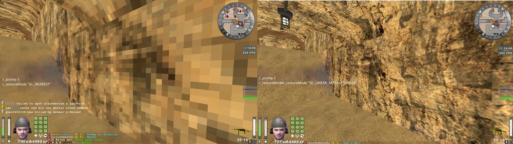

Also you have used r_textureMode "GL_LINEAR_MIPMAP_LINEAR" and these are the Highest-Quality textures in ET. I dont know if you knew this or not but r_textureMode has no effect on FPS. I tested this with r_texturemode GL_NEAREST (worst textures) vs GL_LINEAR_MIPMAP_LINEAR (best textures) and there is absolutely no difference in FPS. So you can make your game look like Minecraft with r_texturemode GL_NEAREST and have no FPS boost.  Same thing with r_picmip 0 and r_picmip 3, no FPS difference. That is with my PC. If you you have low-end laptop, maybe there is difference. It would be nice, if you could test it. Use /timedemo for proper results.
